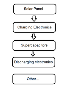

The main idea is - to make a device similar to solar powered power banks, but instead of Li-Ion batteries, use supercapacitors. It shall have a USB output, LED light and status measurement.
There are many projects involving solar charging li-ion or lead-acid batteries. Here I decided to use supercapacitors, because they feel more "comfortable" with non-stop charging/discharging cycles with differents currents and unstable parameters. For sure they will last longer than any battery, and this device can be used for a very long time. They also charge faster than batteries, because they are smaller in capacity and have bigger power efficiency - almost 100% of charging power is stored.
Disadvantages, of course include higher price per mkwh than batteries, higher volume and weight, and less capacity.
As you can see, the device has 4 important parts: Solar Panel, Charging Electronics, Supercapacitors, Discharging Electronics. I will put some details on each one of them:
