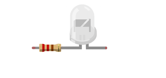

Step 2: Solder the Resistors to LED
The LEDs require only 3V. I'm using a 6V power source as other parts of the console need 6V. To stop the LEDs failing each LED will need a resistor added to the +ve leg of the LED. A 220 ohm resistor will work for 5-6V

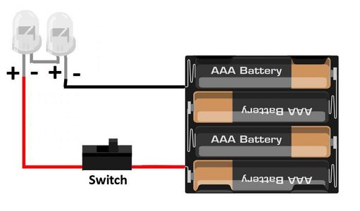

You need to find a clear plastic container that will fit in the plumbing connectors. Anything that can be sealed will do. Drill 2 holes in the lid of the container to push fit the LEDs into. You need to use 2 LEDs as I’m using 5-6V and each LED needs ~3V. By using 2 in series you can avoid using a resistor (It’s best practice to use a resistor to reduce the chance of damaging the LED but you can get away without one). Use hot glue to seal the LED’s in the lid, it needs to be watertight, but ideally not cover the ends of the LED to allow maximum light out.
Step 7: Solder the LEDs
Solder the LEDs in series, that means connect the -ve leg from one to the +ve leg of the other. Then connect the pair to the power supply via a switch.
