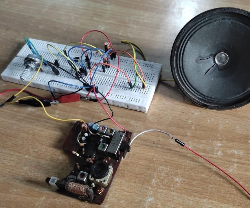

Today in this instructables I shall teach you about a Superhetrodyne Radio Receiver.
