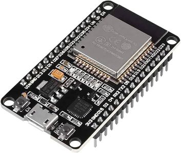

This assembly requires the following electronics:
  1. ESP32(or any arduino like microcontroller)

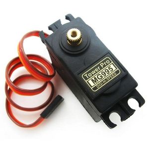

  2. MG995 180 Degree Servo motor: (x1)

Start with the back_cover.stl and Fit the servo motor into the space.
You may encounter that the servo is not fitting (like in the second image), all you have to do is push it to the corner as much as possible, apply pressure and it will eventually go through.
Make sure the servo is aligned as shown in the image where the metal head is next to the little rectangular empty space of the part.
M5 screws are a bit tight and bend the part so u can use M3 screws with bolts for the servo too.

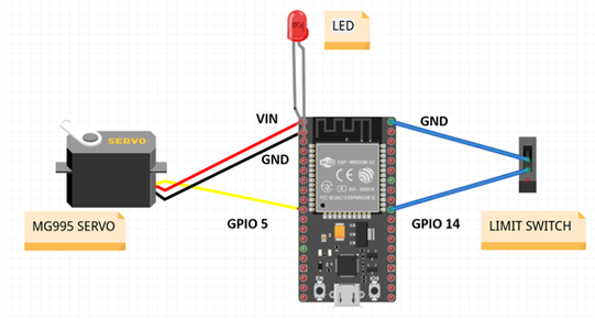

Firstly follow the connection diagram in the image given.
Wire your connections in the similar way (you can assign any other Pins:

Step 5: Electronics Connections
Now connect the switch, motor and LED(optional) as per given diagram in the previous step.
