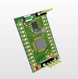

Having explained the supervisor circuits, I decided to design a mini header board based on STM32F030K6T6 to see the results. I uploaded the schematic, which is very easy. Unfortunately, the Zip file is not supported by Instructables. If you need Gerber files, send me an email.
I designed it in Altium designer. And ordered the PCBs from JLCPCB. The quality of PCB is excellent. I ordered 5 pieces of PCBs for 1.85$. As soon as I got them, I started to solder all the components. You can see the latest PCB in the images.

As you can see from the schematic, I connected the TD pin to 3.3 volts. This means that if the MIC1832 does not get the signal in 1.2 seconds, it will reset the microcontroller. It is evident in the first image that the supervisor circuit works properly. As it does not get any signal, it resets the microcontroller. As soon as I generated a signal on the PA4 of the microcontroller, the reset procedure was stopped by MIC1832. And the reset pin remained constant at 3.3 volts.
