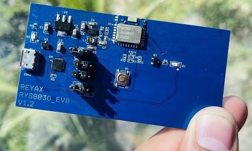

1. Reyax RYS8830 GPS/GNSS Receiver Module: The RYS8830 module from Reyax is based on Sony CXD5605GF/CXD5605AGF technology & comes as a small SMD component. The RYS8830 GNSS modules can be used in tracking devices that need to be small and power-saving. The Reyax RYS8830 has a small form factor and ultra-low power consumption. The GPS/GNSS Module can be interfaced with any microcontroller & can be operated using a simple coin-cell battery.
The RYS8830 Module is a very small SMD Module and requires a PCB. So, in this tutorial, we will use an evaluation board (RYS8830 EVB). The RYS8830 Evaluation Board has an embedded power circuit along with the CP2102 Chip & a micro-USB port. So the board can be directly connected to the computer and using the GNNS Software you can start learning and exploring the feature of the RYS8830 Chip.
You can get details from: http://reyax.com.cn/products/rys8830/

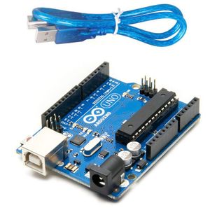

2. Arduino UNO (nothing new to say about it): You can buy one from the aliexpress link (https://s.click.aliexpress.com/e/_Ake0bh)

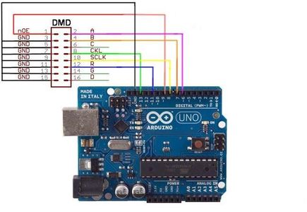

Pin description of P10 display module:
  • Enable: This pin is used to control the brightness of the LED panel, by giving a PWM pulse to it.
  • A, B: These are called multiplex select pins. They take digital input to select any multiplex rows.
  • Shift clock (CLK), Store clock (SCLK) and Data: These are the normal shift register control pins. Here a shift register 74HC595 is used.

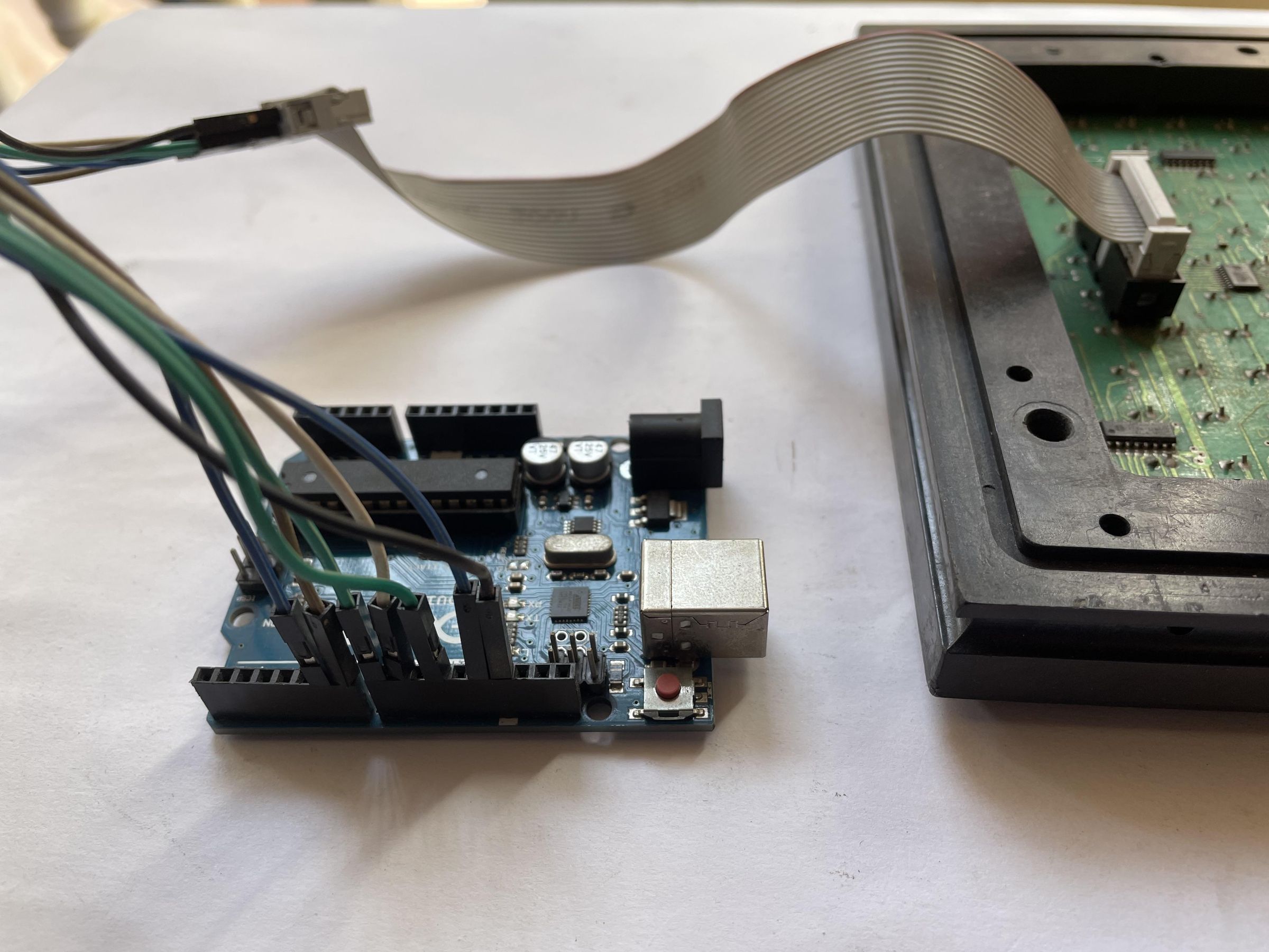

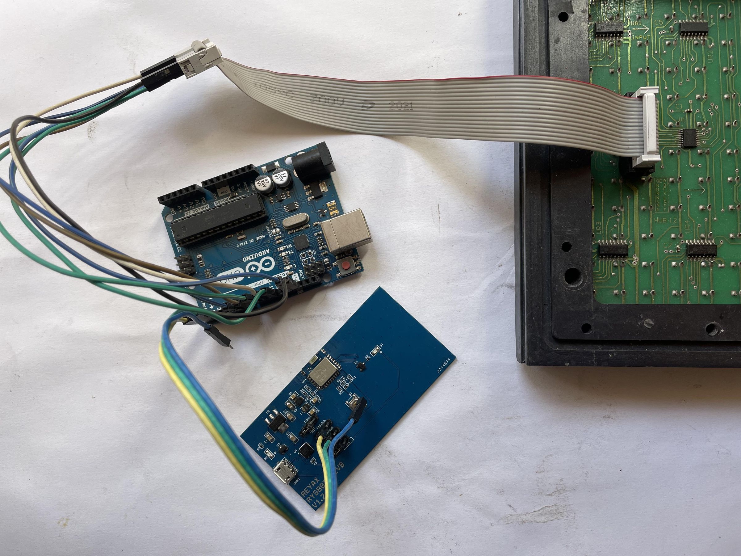

Connection with Arduino
Connection of GPS module & Arduino

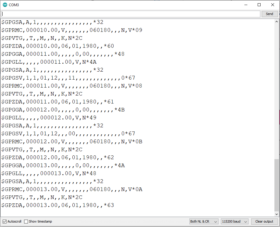

For getting the data we need to connect the RYS8830 EVB evaluation board with the PC. So use a Micro-USB Data cable to connect RYS8830 EVB to the computer. Once connected a red light will flash up indicating the evaluation board is correctly powered. Run any serial monitor software (e.g. Arduino serial monitor, PuTTY) and choose the COM port for the evaluation board. Send @GCD from the serial monitor to the EVB to cold start the device. You will get the data like the following image:
The data shown in the figure above means that the connection is established successfully, but it is unable to perform positioning.
In this case, please place the EVB on the balcony or near the window, or outdoors for testing, because GPS is less stable in searching signals indoors.

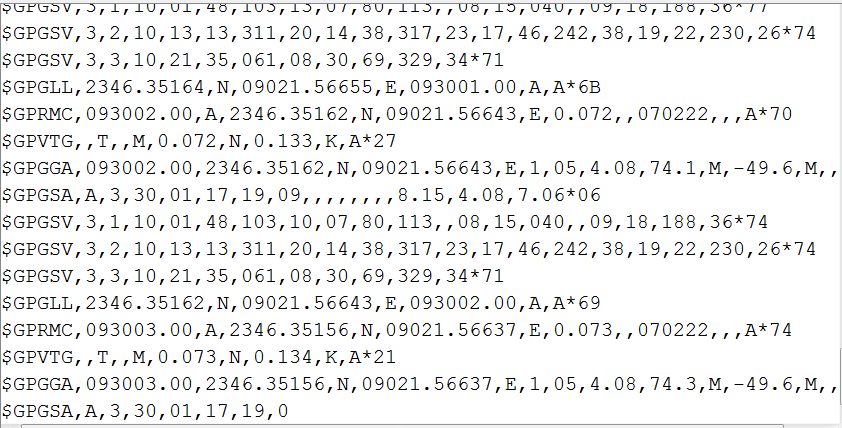

After waiting for a while, if the serial monitor lists similar data in its window as the figure shows below, it means GPS has performed positioning.
For its first positioning after cold starts, the GPS module normally takes 1-3 minutes to finish this positioning successfully in the open air with good weather. So, please be patient. Moreover, if there is bad weather, it may take more time for positioning, or even unable to perform positioning sometimes.
The data you are getting over the serial interface is actually NMEA sentences.
NMEA is an acronym for the National Marine Electronics Association. This is a standard message format for Nearly all GPS receivers.
The NMEA standard is formatted in lines of data called sentences. Each sentence is comma-separated to make it easier to parse by computers and microcontrollers.
These NMEA sentences are sent out at an interval called the update rate which is 1 sec for the RYS8830.

Let’s take an example of $GPRMC NMEA sentence from a GPS receiver.
$GPRMC, 123519, A, 4807.038, N, 01131.000, E,022.4, 084.4, 230394, 003.1, W*6A
$ --> Every NMEA sentence starts with $ character.
GPRMC --> Global Positioning Recommended Minimum Coordinates
123519 -->Current time in UTC – 12:35:19
A --> Status A=active or V=Void.
4807.038,N --> Latitude 48 deg 07.038′ N
01131.000,E --> Longitude 11 deg 31.000′ E
022.4 -->Speed over the ground in knots
084.4 --> Track angle in degrees True
220318 --> Current Date – 22 rd of March 2018
003.1,W --> Magnetic Variation
*6A --> The checksum data, always begins with *
For more details about the NEMA please refer to the software guide attached here.

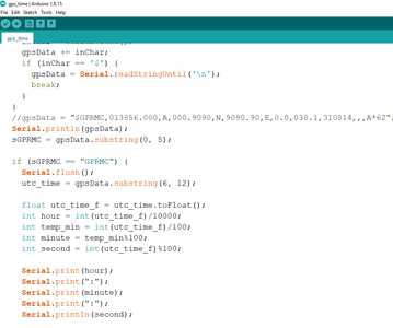

Test code for extracting time from the NEMA data received by the GPS module.
char inChar;
String gpsData;
String sGPRMC;
String utc_time;
void setup() {
   Serial.begin(9600);
void loop() {
  while (Serial.available()) {
    inChar = Serial.read();
    gpsData += inChar;
    if (inChar == '$') {
      gpsData = Serial.readStringUntil('\n');
      break;
  //gpsData = "$GPRMC,013856.000,A,000.9090,N,9090.90,E,0.0,038.1,310814,,,A*62";
  Serial.println(gpsData);
  sGPRMC = gpsData.substring(0, 5);
  if (sGPRMC == "GPRMC") {
    Serial.flush();
    utc_time = gpsData.substring(6, 12);
    float utc_time_f = utc_time.toFloat();
    int hour = int(utc_time_f)/10000;
    int temp_min = int(utc_time_f)/100;
    int minute = temp_min%100;
    int second = int(utc_time_f)%100;
    Serial.print(hour);
    Serial.print(":");
    Serial.print(minute);
    Serial.print(":");
    Serial.println(second);

 * PIN Configuration
 * Arduino              P-10
 * -D6          ->      -A
 * -D7          ->      -B
 * -D8          ->      -SCLK
 * -D9          ->      -OE
 * -D11         ->      -DATA
 * -D13         ->      -CLK
 * -GND         ->      -GND
 * Arduino              RYS8830 EVB
 * -TX          ->      -RX
 * -RX          ->      -TX
 * -GND         ->      -GND
