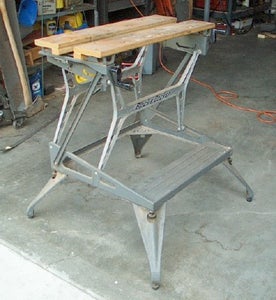

This is my venerable 35 year old Black & Decker Workmate. I most often use it as a base for several power tools normally mounted on a bench.

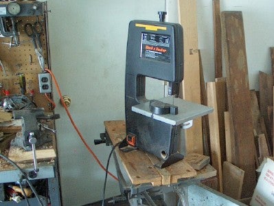

My workmate allows me to make better use of my garage workshop that shares space with our automobiles. Here you see my bandsaw mounted on my Workmate. The Workmate fits into a cramped corner.

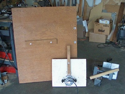

This is my homemade router table. To use it I need only loosen the Workmate's jaws and substitute the router table for the bandsaw. If I need more space for handling the work I am routing, I can move the Workmate into a more open area, or even take it outside the garage.

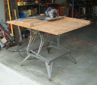

Almost two years ago I published an Instructable on a quick conversion table for making accurate cuts with a circular saw. See it here. I use my Workmate to mount this quick conversion table. I could also use two sawhorses.

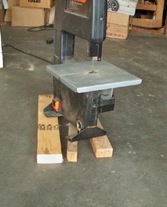

The router table and the saw table both store upright against a wall. The bandsaw is usually in my Workmate, but if I need to support it while it is out of the Workmate, I can use a couple of pieces of 2 inch lumber as shown in the photo.

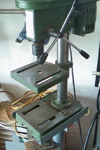

I have a small Chinese drill press of the type that is exported all over the world. A few years ago I made a welded stand for it. But, I could mount it on my Workmate. Notice the two mounting holes identified by the two yellow text boxes. I could use these holes to attach a 2 x 2 cleat like is on the other tools. If I did use this drill press on my Workmate, I would need to use some 2 inch lumber to store it like those seen in step 5. I do like to use my drill press on the stand I made because the height of the stand makes it easier to use than it would be on my Workmate.
