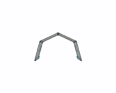

Step 4: Assemble the Structure
Use joints to assemble the skeleton of the tent.
Tent Structure

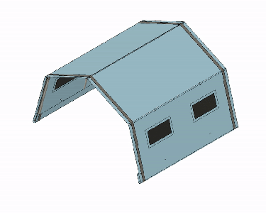

Step 5: Create the Canvas
  1. Insert the skeleton structure
  2. Create a sketch around the skeleton structure, representing the side-on shape of the tent's canvas on one side. (Sketch1)
  3. Create a sheet metal flange from the Sketch1's contour.
  4. Create a sketch on the inner face of the canvas what will have the window. Sketch the window's shape, and connecting tabs that would be on the same face as the window. (Sketch2)
  5. Use the split face tool to split the inner and outer window-faces using the window sketch from Sketch2.
  6. Assign the window the appearance of a transparent/translucent material.
  7. Extrude the connecting tabs on Sketch2.
  8. Fillet the connecting tabs to make them look realistic.
  9. Fillet the connecting tabs to make them look realistic.
  10. Create a sketch at the outer peak of the canvas (parallel to Sketch1) for the curved brackets around the poles/joints. (Sketch3)
  11. Extrude the brackets from Sketch 3.
  12. Extrude the brackets from Sketch 3, but start the extrude from an offset, creating another, similar set of brackets.
  13. Unfold the canvas.
  14. Create a sketch along the outer surface of the canvas of a long rectangle. This sketch will represent the Velcro that allows two SureShelter to expand. (Sketch4)
  15. Extrude Sketch4 outward.
  16. Give this feature a darker color, representing the 'hooks' side of the Velcro.
  17. Extrude Sketch4 inwards, starting on the inner face.
  18. Give this feature a lighter color, representing the 'loops' side of the Velcro.
  19. Refold the canvas.
  20. Mirror the whole canvas across the XY plane.
  21. Mirror the whole canvas across the YZ plane.
  22. Remove the skeleton structure from Step 1.
Tent Canvas
