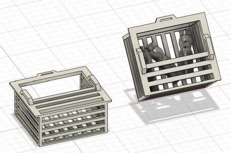

Using a simple fit in place basket with partial enclosure which helps in an easy pull up mechanism to collect waste.

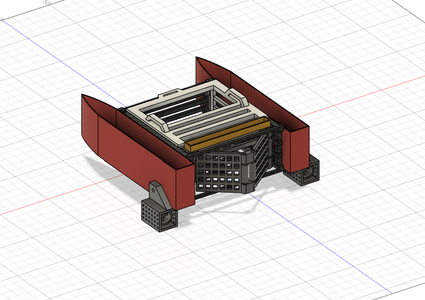

Frame Design
02-02-2024: The main frame of the ASV is made of (f).1 with dimension 1000mmX1000mmX420mm and uses (f).2 i.e 3d printed 3- and 4-way joints.
Total Volume of 440L, considering Buoyancy and floating nature of plastic the ASV is expected to collect 40 to 60 L of waste in a single run.
19-12-2024: After that the model was scaled to 80 percent and continued to be used till now.
Propulsion System
Thruster Mounts: In the current stage the thruster is attached directly to the main frame on each side with 5 mm bolts
Steering Mechanism: Uses differential thrust
Hull design
02-12-2024: Shape: As we are using a catamaran model ASV with 2 identical and symmetrical modular hulls.
Material Selection: At Stage 2 prototyping, as of now we are using a 1400mmX20mmX40mm 3d printed hull design (not tested/simulated) with epoxy to water seal the hull.
For Stage 1 prototype we used a 6-inch PVC pipe
03-03-2025: Now a fully 3d printed 160cmX250cmX250cm hull printed out of pla+ is used in the Stage 2 model

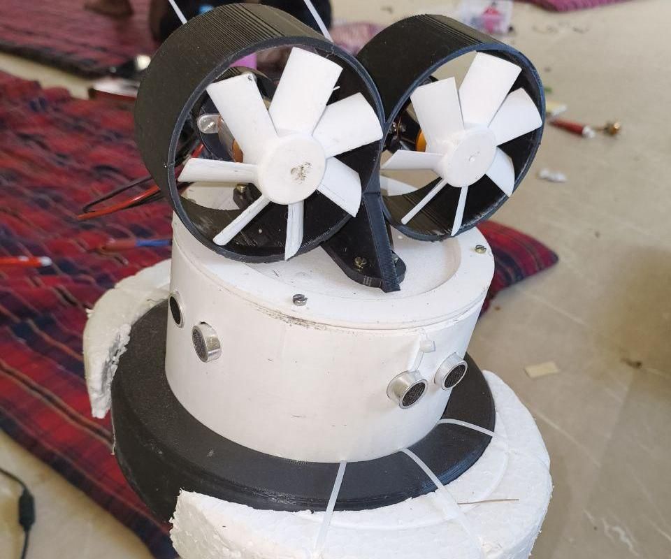

Step 4: Thruster Design V1 (Discarded)
For thrusters we initially used a 2836 750kv BLDC and for that used a 5inch diameter and 8inch pitch tri blade propellor(t).1.
02-12-24: Currently we are experimenting with newer propellors, and suggestion are appreciated.

Step 6: Initial Prototype & Stage 1 Testing : 31-12-24
Stage 1 prototype was used to experiment with different motors, propellors, speed and buoyancy.
Team Members (prototype making):
  1. Jerrin Shibu (me, back left), 4th year CEC
  2. Vignesh J R (front right), 3rd year CEC
  3. Vijay Satheesh, 3rd year CEC
  4. Yohan CM (front left) ,4th year CEC
  5. Bhavesh Sanjay (camera guy <3), 3rd year CEC
  6. Jeffin Shibu (back right), my mentor & postgraduate, IITM
Observations
  1. 2836 motors are not sufficient
  2. FDM 3d printed propellors gets damaged easily
  3. As we got to test the robot at evening lack of lighting really made us have a hard time.

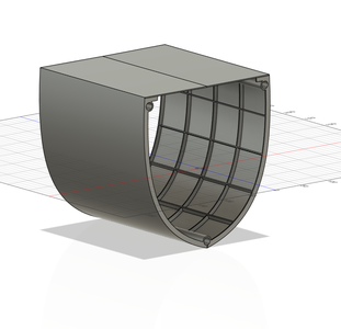

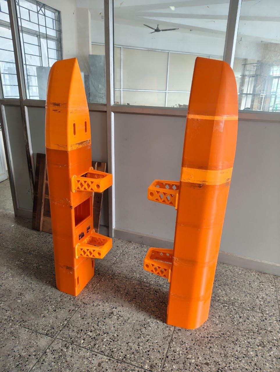

Step 8: 3d Printable Modular Hull
Modular Hull Made to Stack up distance , each module having dimensions 250X250X250mm.
Step 9: Material Research for 3d Printed Hull
03-03-25: Currrently Testing out the 3d printer settings with different materials and PLA composites, including PLA LW, PLA + , ASA and PETG.
Currently Using .8mm hardened steel nozzle,and 12 mm Carbon Fiber Rods to connect the modules
Step 10: Hull Design Revisons
Finally revised the design by taking inspirations from other fellow creators.
Step 11: Printing All Files
3d printed the hull 2 hulls, one with mixed infills for strength validation(right) and other with 10 - 15 percent infill to test weight reduction(left) with a total of over 40+ functional parts and 400+ print hours at 400mms and .48-.4-layer height.
Step 12: Testing Hull Assembly

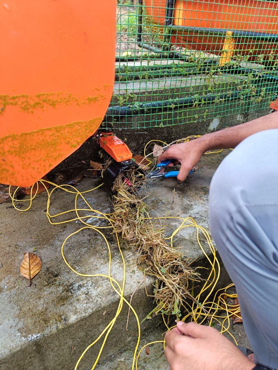

Initally assembled the hulls with duct tape and friction fitted 12 mm hollow CF rods
The partially assembled hull was tested on nearby canal.
Observation:
  1. Zero noticeable leaks.
  2. As the wall thickness is only 1.6mm a strong impact on sides and add unnoticeable layer tear, so a coat of epoxy or fiberglass would be preferred.
  3. As am 70kg and its total volume is above 140L, Custom hull simply increases the look and mechanical properties anyways.
Step 13: Hull Assembly

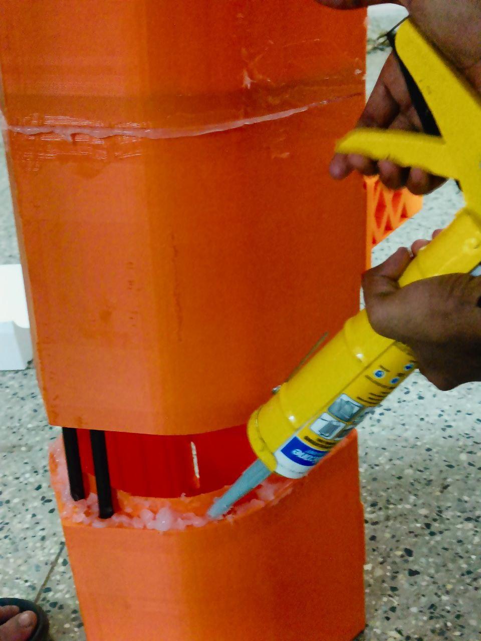

Assembled with clear silicon and m5 & m6 bolts and left should leave the silicon to dry up for min 3 days to a week.
Also, it's better to leave it upright and push down gentle from above after the assembly.

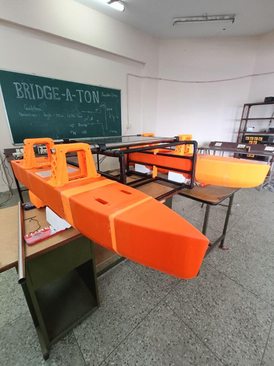

Step 14: Full Assembly
Assembled the Hull to the improvised old frame(800cmX800cmX32cm) with custom multipurpose handle and all other 3d printed parts including custom waterproof containers, frame strengtheners and mounts.

  1. When you fill silicon while assembling add it much more than you feel needed else minor air gaps can potentially lead water leaks and was observed in hull1 as we filled hull 1 with enough silicon and 2 with much more then needed.
  2. Plastic Props and not build for tough environment.
