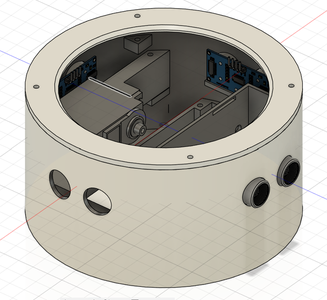

Step 1: Designing

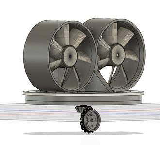

Aimed at making a design that can take sharp 90 degrees easily .
Used a 1:2 gear ratio to convert 180 degrees to 360 for the rotating thruster's .

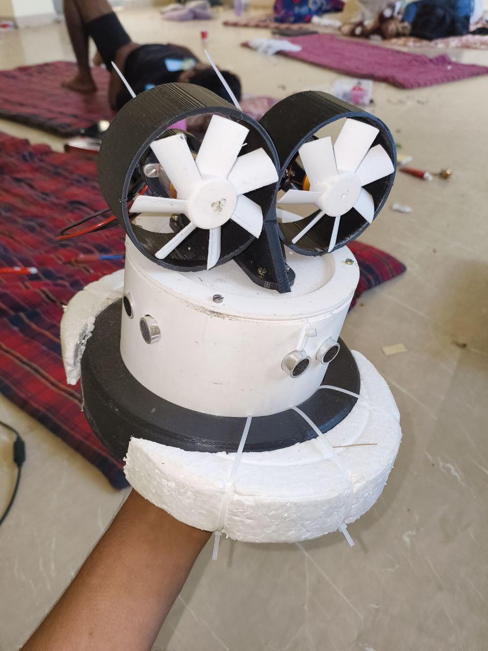

Step 2: 3d Printing and Prototyping
All the files are sliced and printed with Bambu Studio and Bambu Labs A1.
Used 1.5 inch thick foam to fill the robot's base and to balance it.

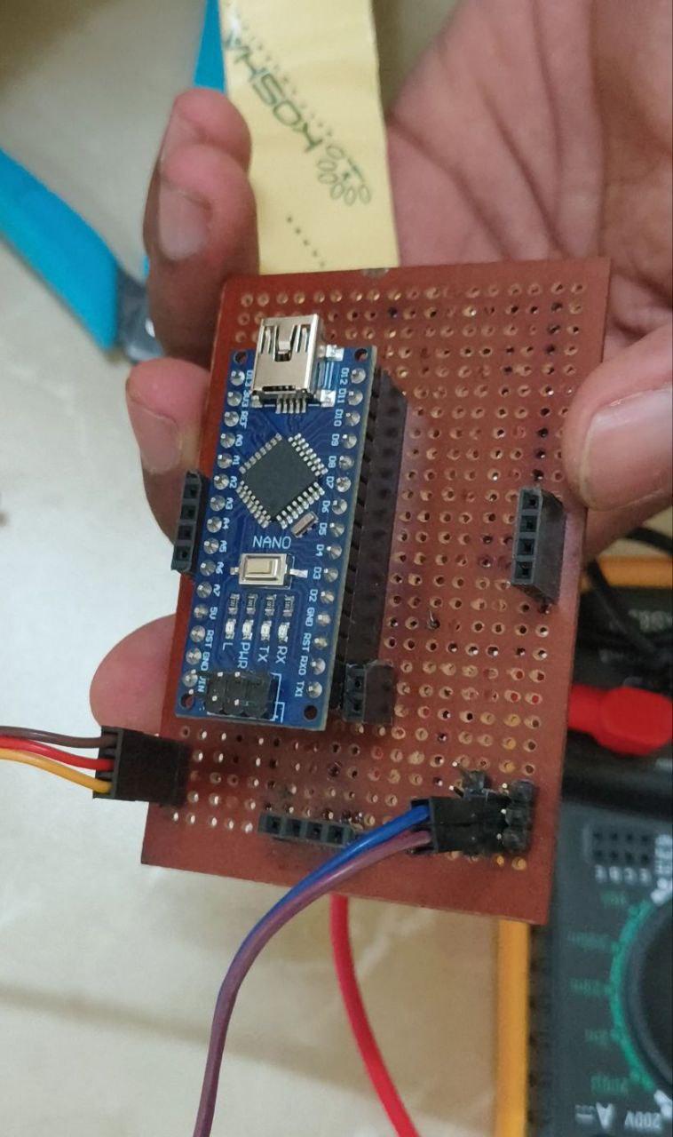

Step 3: Electronics
We used DotBoard and headers to fit in 3X HCSR04,1X ESC ,1X Servo ,Vin.
