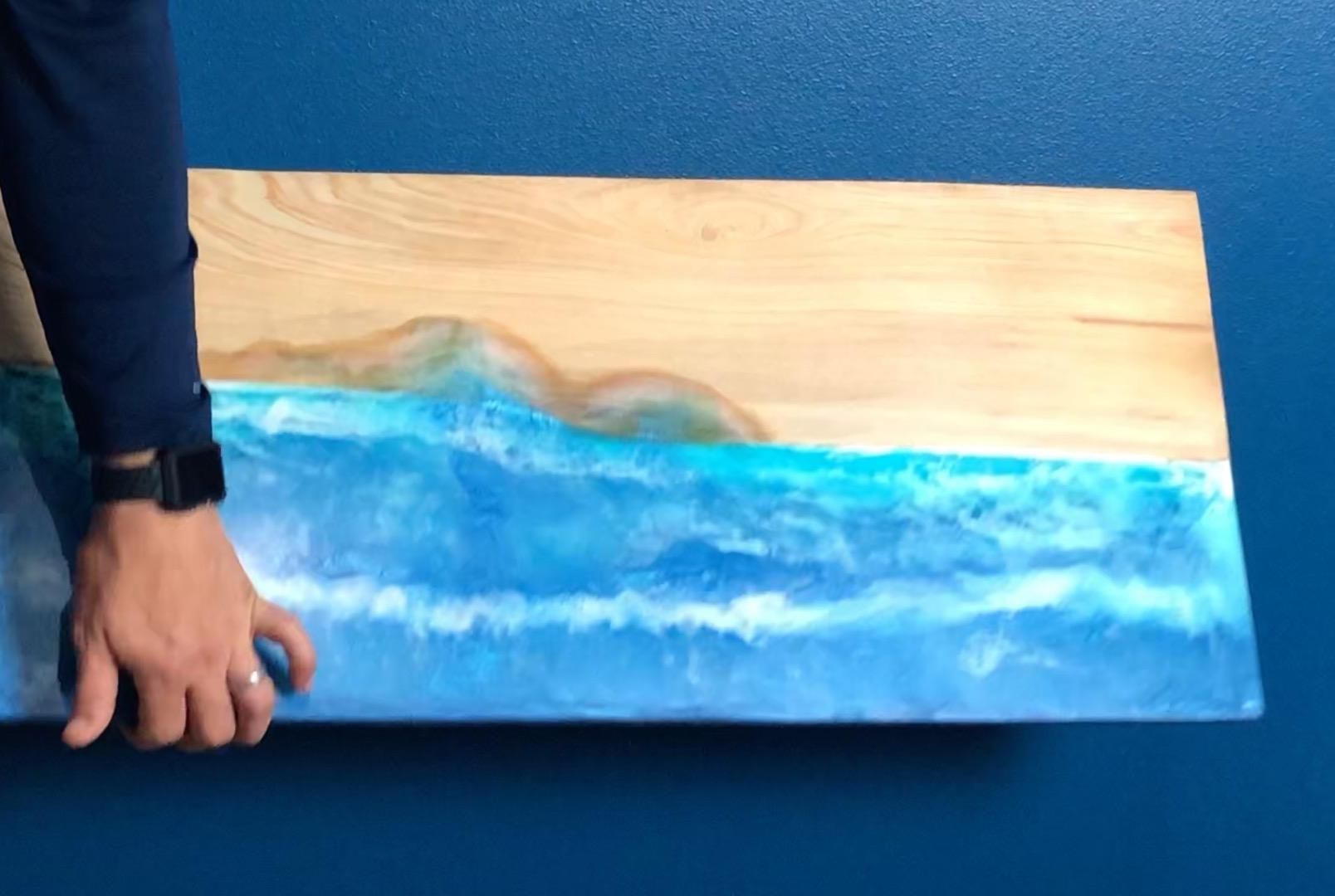

I wanted the void in the middle of the table to be translucent blue and the side of the table to be opaque blue.
Essentially, the translucent blue resin part of the resin and wood wall art would be shallow water and the opaque blue would represent deeper water.
I mixed 1 large batch of epoxy resin and split them equally in 2 different containers.
Next, I put one drop of transparent blue dye in one container. In the other container, I added a splash of sky blue pearl pigment powder and a splash blue glow powder. I mixed both thoroughly with a stir stick.
Basically, I added more or less dye and pigment powder until the color looked good to me.
Step 4: Epoxy Pour
I poured the transparent blue resin within the void. Once the transparent blue resin reached the end of wood and resin surfboard, I poured the opaque blue.
NOTE: If you notice the epoxy color is too light when you start pouring, I recommend to only fill up the void halfway. More info about this in the next step.
Next, I covered the section on side of the wood and resin art with the opaque blue resin.
The depth of the resin pour ended up being about 3/8″. Make sure to follow the manufacturer's recommendation on the depth of the pour. Some epoxy may require multiple pours.
I used a heat gun to remove bubbles and blend the translucent and opaque blue colors at the meeting point.
I mixed a small amount of epoxy and white pearl pigment powder. I poured this on side of the piece to represent ocean wave foam. I thought it would add a cool effect to the piece.
Step 5: 2nd Epoxy Pour (Optional Step)
After the epoxy cured overnight, I needed to darken the color a bit with a second epoxy pour and repeated the steps above. This is the reason I stopped halfway on the previous step. By only filling up half the void, I gave myself room to add a second layer to darken the color.
