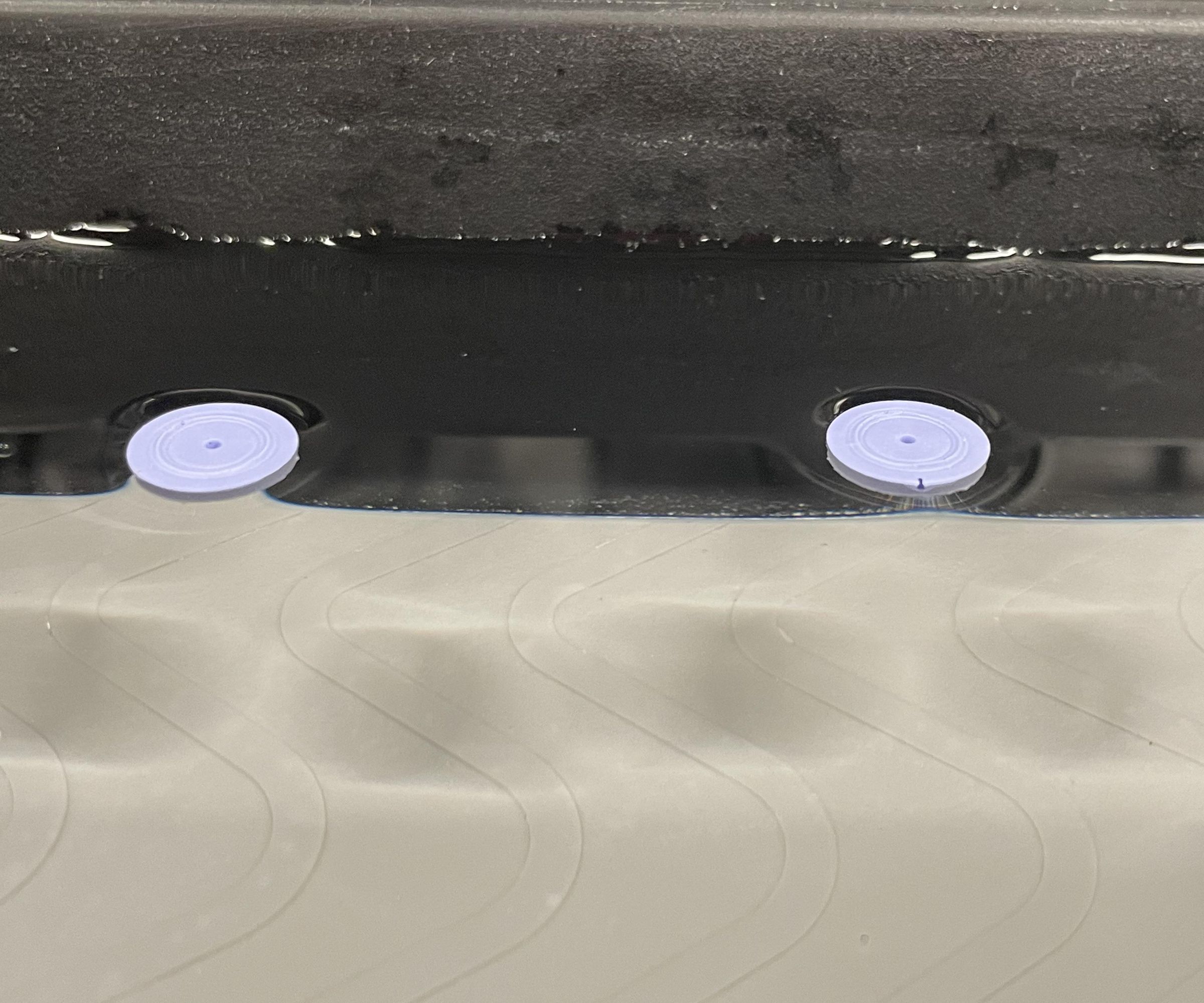

Step 4: Place the SurferBot on the Water
Place the vibrating SurferBot on the water in your tub, making sure that the body remains dry with a clean contact line of water and no air bubbles underneath. Watch the SurferBot go!
