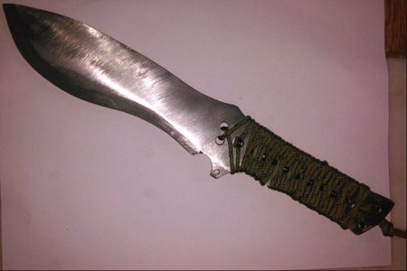

Introduction: Survival Knife 3
Overall Length: 33 cm
Blade Thickness: 5 mm
Blade Material: Uddeholm sleipner steel

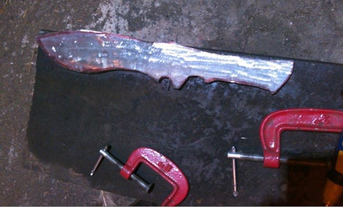

Step 1: Grinding

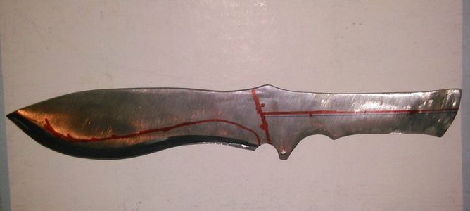

I used Uddeholm Sleipner tool steel, 8mm thick. But the knife should be about 5 mm thick, so it should be ground. Use a dust mask for safety.
Step 2: Profiling the Knife Shape

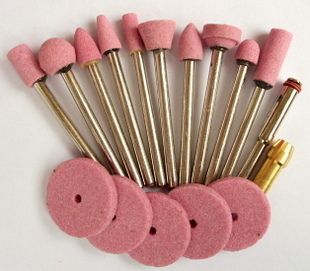

Profiling the knife shape with an angle grinder. Use drill grinding wheels to profile the curves of the knife.

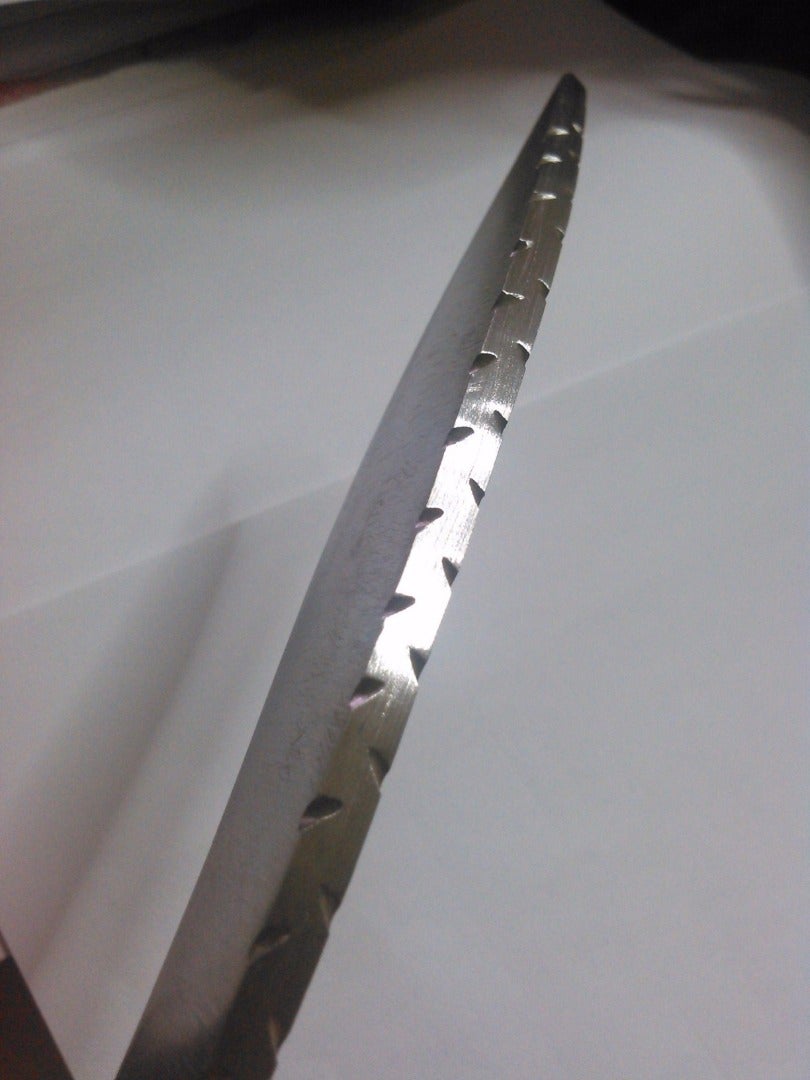

Step 6: Filework

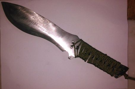

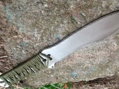

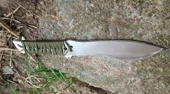

Step 7: Final Step.Paracord Knife Wrap
