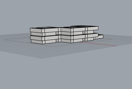

Using the help of AutoCAD and Rhino I was able to model out what Camino Unido would look like to scale. These tools allowed me to accurately map out key components to the space. Working to scale helped me understand better how the residents and staff will move through the space and helped me refine proportions of the space.
