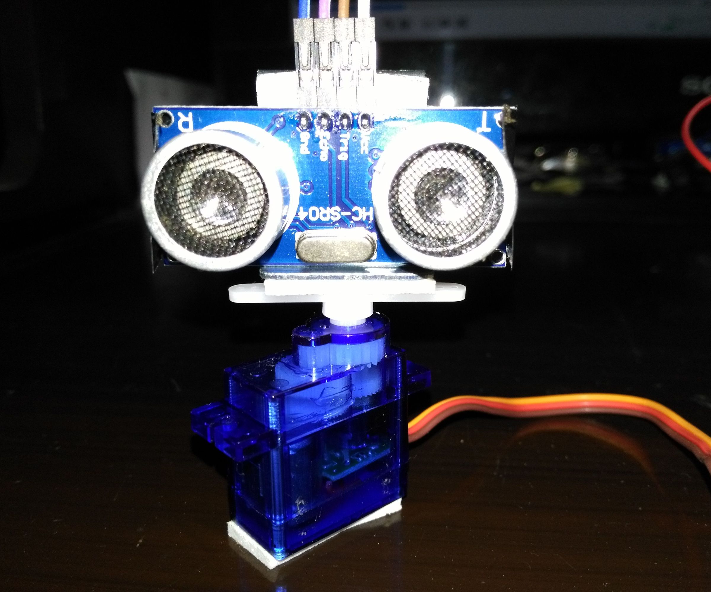

The objective of this instructable is to make a setup in which a Ultrasonic sensor is mounted on a servo motor.
I've considered a micro servo (90g), and a red LED.
The connections need to be made as seen in the Fritzig diagram.
Attaching the Ultrasonic sensor and the servo arm should be done using double sided tape and insulation tape.
(Do not consider the joystick, i forgot to remove it)

The code is as follows:
#define trigPin 7
#define echoPin 6
#define led 13
#define buzzer 11
#include
int ServoHorizontalPin = 3;
int HorizontalPotPin = A0;
int HorizontalPotValue = 0;
int ServoH_Min = 0;
int ServoH_Max = 180;
int pos = 0;
int sound;
Servo HorizontalServo;
int HorizontalServoPosition;
void setup()
HorizontalServo.attach(ServoHorizontalPin);
Serial.begin (9600);
pinMode(trigPin, OUTPUT);
pinMode(echoPin, INPUT);
pinMode(led, OUTPUT);
pinMode(buzzer, OUTPUT);
void loop()
for (pos = 0; pos <= 180; pos += 2)
alarm();
for (pos = 180; pos >= 0; pos -= 2)
alarm();
void alarm()
HorizontalServo.write(pos);
delay(25);
long duration, distance;
digitalWrite(trigPin, LOW);
delayMicroseconds(1);
digitalWrite(trigPin, HIGH);
delayMicroseconds(2);
duration = pulseIn(echoPin, HIGH);
distance = (duration/2) / 29.1;
if (distance < 20)
digitalWrite(led, HIGH);
analogWrite(11, 20);
else
digitalWrite(led,LOW);
analogWrite(11, 0);
