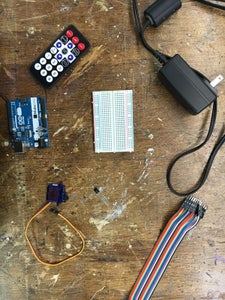

Step 1: Things You Need
- Remote Control
- Arduino Uno
- Breadboard
- Jumper wires
- Servo Motor
- IR Receiver
- Power Cord
- Camera Mount (specific to your camera, to secure the camera)
- Plywood

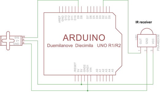

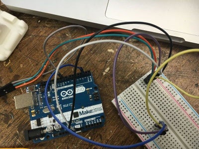

We use arduino UNO to control the servo motor to make the functionality we want.
We use IR receiver to read IR signals from remote control. Wiring IR receiver and servo motor is shown in pictures. Follow the steps of wiring in the pictures.

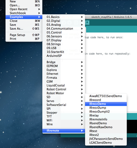

First, open the Arduino Software.
Open the sketch menu > Include Library > Manage Libraries > Search for IRremote, install it. Now open a new project in your Arduino Software. Open the Files menu > examples > IRremote > IRrecvDemo. Next, verify and upload to your adruino board. Then open serial monitor and try to click on any button of remote control to send a signal to IR receiver, the HEX code of each button. Then detect the HEX code of the buttons using to control the servo motor, assume you will use five buttons of your choice. For example, use (Right Arrow) for 0 degrees and (Left Arrow) for 180 degrees, so you have to get their HEX codes. (R) ---> A3C8EDDB (L) ---> F076C13B In the final code, the functionality is when clicking at any of five buttons the motor is toggling between the rotation in main direction and stop so when first click at any of two buttons the motor will rotate in button's direction, and when second click at same button the motor will stop as shown in the video. The code is:

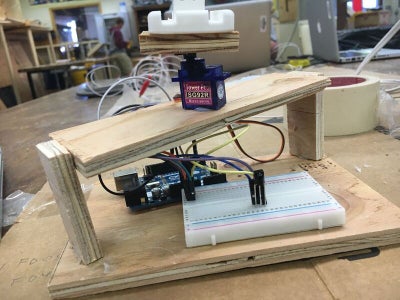

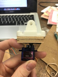

Step 5: Attach Your Mount

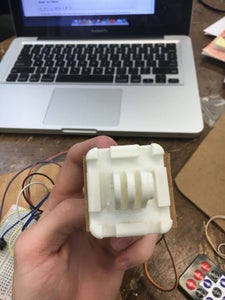

For this step I will be using a 3D-Printed GoPro Mount, but you can use any mount that supports you camera of choice. I super glued the servo to a piece of wood, them super glued the mount to the wood.
Step 6: Start to Enclose the Mount

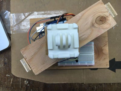

To begin to enclose my mount I simply took a piece of plywood for the base, then made a level raised platform for the servo to sit on. I then just allowed my wires, Arduino, and breadboard to sit underneath.
Step 7: Enclose the Materials
Build walls around the materials and cut a hole in the one wall for your power cord and a one for your IR sensor to be able to pickup signals from your remote. To weather proof the box simply put saran wrap or cling wrap over and around all openings.
