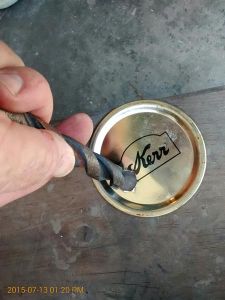

Step 1: Drill Out a Canning Jar Lid to Accept a Fermentation Lock

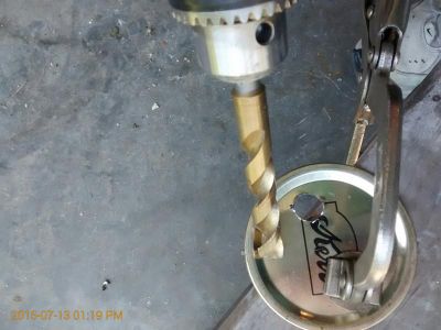

Using a 1/2" drill and a clamp, drill a 1/2" hole in a canning jar lid. Use a larger drill bit, such as a 3/4" bit, to deburr the hole. You may also use a hammer to flatten out burrs.

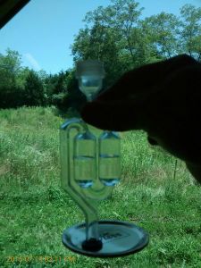

Step 2: Install a Fermentation Lock
The fermentation lock is a plastic S-Curved tube that allows gas pressure to escape, but locks out oxygen. It fits in a 1/2" rubber grommet. Both can be obtained at a homebrewing store or ordered from various internet sources.

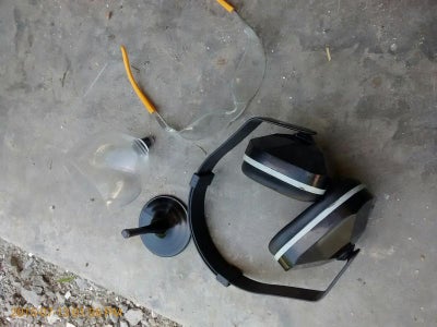

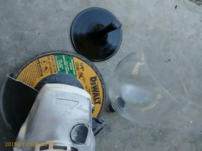

A pickle weight is a glass or ceramic (never metal - metal will corrode in the brine) object that is just small enough to fit inside the canning jar mouth. I found some old wine glasses that had just the right size stem. Grind it off with a side grinder (USE SAFETY GLASSES) - just nicking it all around allows you to snap the glass cleanly. Deburr sharp edges and wash thoroughly. (DID I MENTION THE SAFETY GLASSES?) This will go on top of your veggies, weighing them down to prevent floating above the brine.

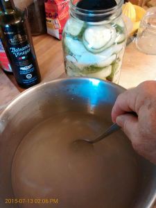

- In a large bowl combine:
- 88 grams canning and pickling salt (Measure by grams, not volume, as salt can vary in density)
- 1000 mL (4 cups) warm water (~40C)
- Juice of one lemon
- 500 mL (2 cups) Xylotol, a low-glycemic index, non-nutritive sugar good for diabetics. You can use regular sugar if that's not a big deal to you.

Now that you've got a canning jar with spices and oak or grape leaves at the bottom, and brine at the ready, you can add veggies!
About 5 cups of veggies should fill a half gallon jar. Alternate them, adding onions, cukes, zukes, carrots, and so on in layers until you are near the top.
Notice I haven't said anything about sterilization? This isn't canning. We are relying on the brine to set up the right conditions for proper, beneficial fermentation. This is a well-studied and safe phenomenon. Make sure things going in are cleaned, but they don't have to be sterile.

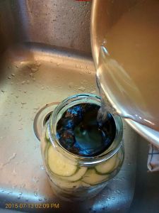

Now add your pickle weight, and pour brine over the top until there is a 1/2" air gap. Don't allow any veggies to stick up above the brine, or they may mold!

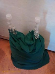

Step 7: Add Fermentation Lock, and Place in a Cool Dark Spot for 1-4 Weeks
Add the fermentation lock and lid assembly. Make sure the fermentation lock tube is above the top of the brine level so gases can escape. Fill the Fermentation lock half full with water on both sides.
Place the pickles in a cool area, like a basement or a slab floor, and cover to keep out light.
In 4 days you should see it bubbling, by a week it should be edible as pickles, or you can wait longer and let the beneficial probiotics develop up to 4 weeks. Toss it on the compost pile if you see any signs of mold, which are prevented mostly by keeping all veggies under brine.
