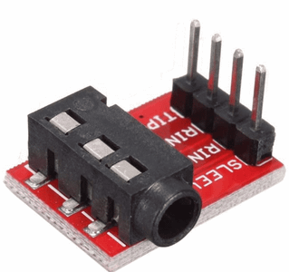

  4. 3.5 mm audio jack breakout board: https://www.amazon.com/Onyehn-Breakout-Stereo-Headphone-Arduino/dp/B07L3P93ZD/ref=sr_1_2?keywords=arduino+3.5+mm+jack&qid=1638929241&sr=8-2

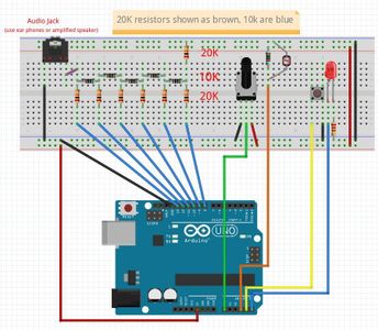

Step 1: Start With a Sine-wave Generator
The first circuit outputs a sine wave whose frequency is controlled by a potentiometer (AKA a "pot"). Here are the steps:
  1. Build the circuit shown in the Fritzing diagram
  2. Connect an audio device such as earbuds or amplified speaker (see below)
  3. Upload the program and fiddle with the pot.
  4. If it works, you can move to the next step
Getting the sound out. An Arduino cannot source enough current to connect a speaker directly. One approach is to add an audio amplifier circuit to drive a speaker. A simpler approach is to use equipment most people already have laying around, including: (1) headphones or earbuds, (2) an amplified speaker from an old PC, or (3) an audio cable connected to a PC Mic or Line-In input. If you do this, it's better to use the Line-In rather than the Mic (which can saturate).
Connect the audio jack like this: Wire the sleeve to ground, and the tip to the left-most 10K resistor as shown.
Note: the picture shows a Digilent "Analog Discovery" board attached to the breadboard. This is not required for the project, but simply provides a convenient way to visualize the output waveform.
