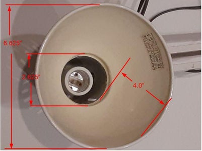

Step 4: The Reflector's Measurements
The following measurements are for the reflector on the swing arm lamp shown. The inside surface of the reflector is is roughly parabolic so a foil lining will have to be applied in stripes to prevent folding of the foil as it is applied. The rim diameter is 6.625 inches and necks down to 2.625 inches in diameter at the bulb’s socket. The circumference of these two diameters are 20.8 inches and 8.25 inches respectively. The distance between the rim and the bulb opening is 4 inches.

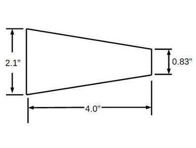

Step 5: Fabricating the Reflector Strips
I decided to use ten stripes to line the reflector. The length of the reflector is 4 inches. Each strip will be 4 inches long and trapezoidal shaped. The width of the strip at the rim will be 20.8/10 = 2.08 ~ 2.1 inches. The width of the strip at the socket will be 8.25/10 = 0.825 ~ 0.83 inches. The figure shows the dimensioned drawing of the strip.
