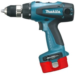

- Drill

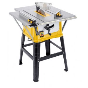

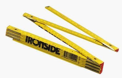

- Measurer

Then drill a hole of Ø25 mm with the spade bit. Try to be as straight as possible when you drill this hole. If you have a table drill, use it, this will be more accurate!
