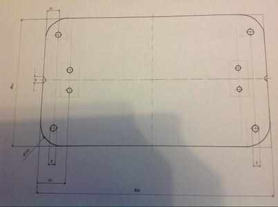

First of all we need a design for our swing.
How does it have to look like?
How many cords will it have?
How will you hold it up?
I chose for a normal multiplex plate. The only thing I did was adding some first generation curves. So no sharp corners on the swing.
The whole swing stays up because of two cords. They are attached to the wooden plate by splicing (more about that later) and a clamp.

Step 3: Fit Up the Wooden Plate
Now that we have all our materials and tools we can start working.
The plate that I used is 30cm on 50cm.
1. I made the drawing on the wood. You can see a paper version in the pictures.
2. I drilled the holes for the cord to go around - but under - the plate.
3. Because the cords can still move, I made a slot at the bottom of the plate. It goes from one drilling hole to another and has the depth of the cord. By doing this the cord 'dissapears'. Just pay attention that you don't go to deep with the machine!
4. I marked the first two of 4 holes for the clamp. First drill one hole. Fix the clamp (temporary) and sign of where the second hole for the clamp has to come. In my first try the clamp moved a bit and the holes didn't fit.
5. Fix the clamps with the M6x50 bolts.
