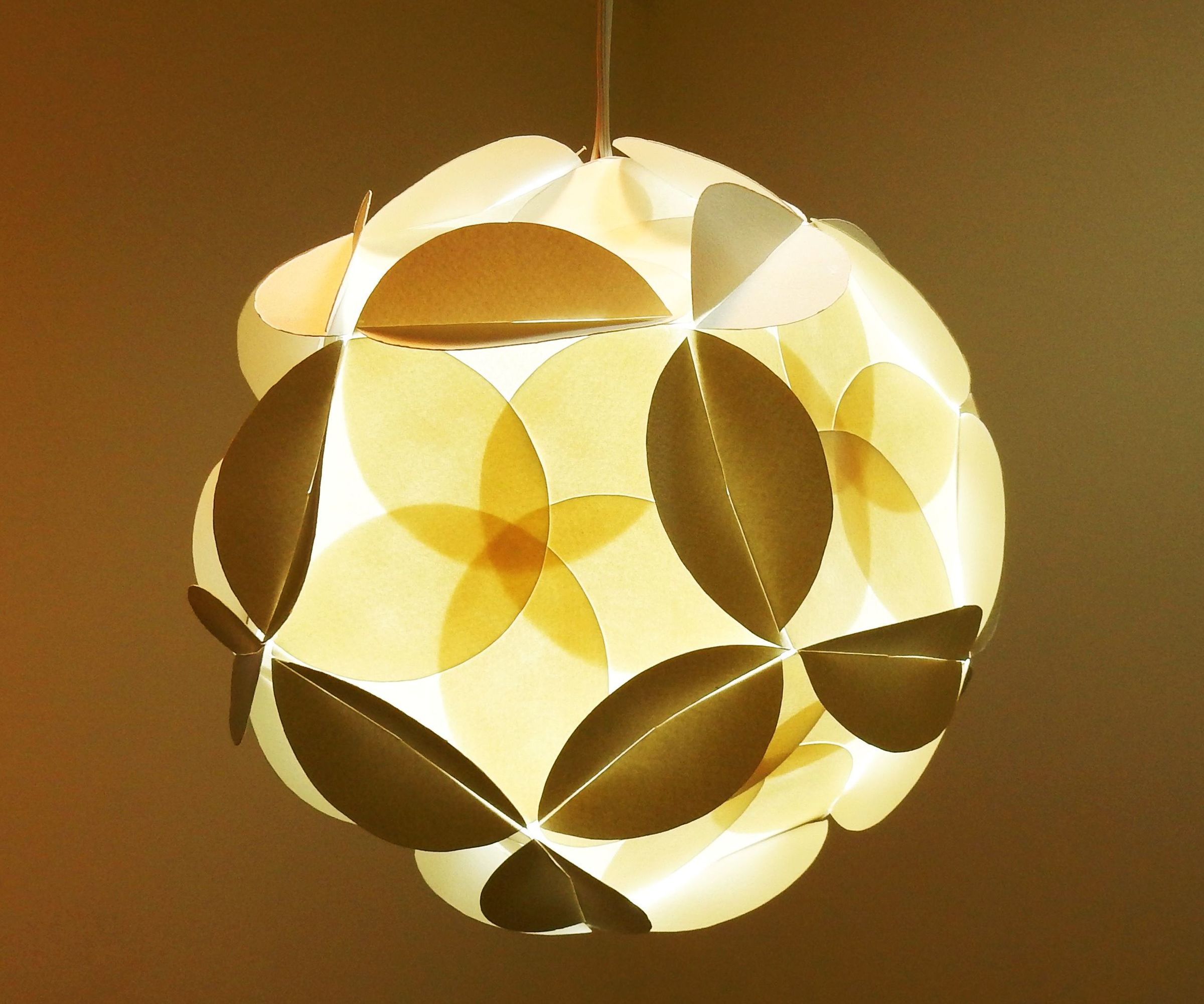

I was looking at all the spiral lamps on the web and highly intrigued by the art forms. I started constructing it in my head and looking out for some handy materials that can be used to make one. This is a lamp that you can make with ease. Not only is it a great decor item for your living space, but a great addition to your parties. Using only simple materials like paper cups and sketch pad, you can produce a spiral elegant lamp, much of a designer's taste. Here I provide written instructions, as well as a video tutorial.
