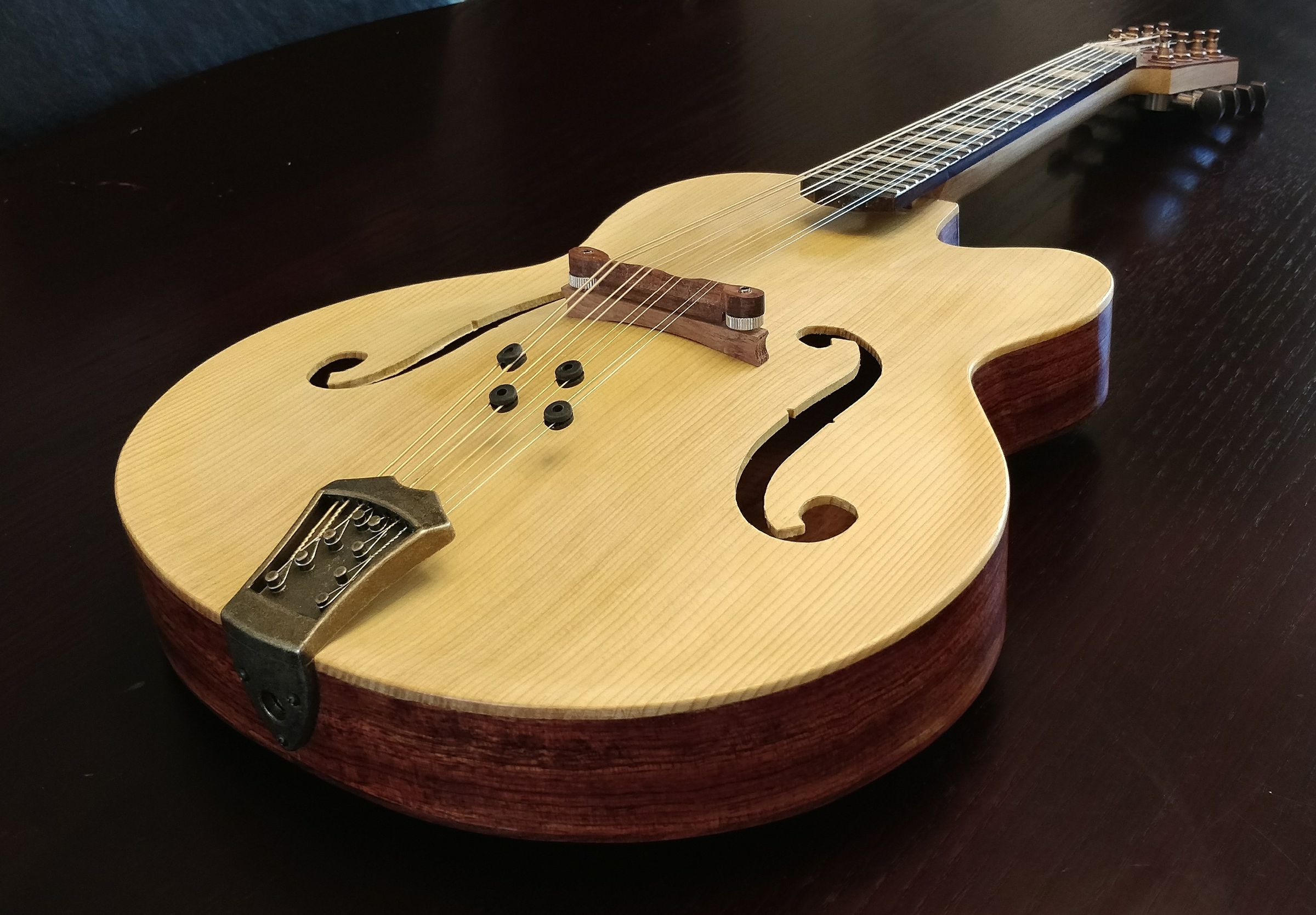

Introduction: Swirl and Water Droplet Painting a Guitar Body
Now that you have your guitar body made Its time to finish it. If you have gone to all the trouble of creating a custom instrument then why give it a solid color finish. these are a few of my finishing tricks that will give you a dynamic and striking finish for your custom creation.
