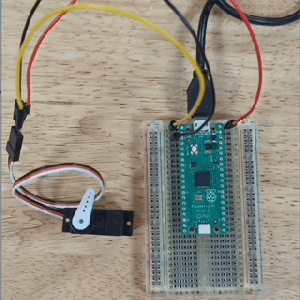

Step 1: Connect Servo Motor to Pico
Connect the servo motor to the Pico:
  1. Motor Power (Red) to Pico VBUS (Pin 40)
  2. Motor Ground (Black) to Pico Ground (Pin 3, 8, 12, 18, 23, 28, 33 or 38)
  3. Motor Signal to Pico GP0 (Pin 1)
Upload the MicroPython code to the Raspberry Pi Pico. I use Thonny, but there are lots of ways to do it.
from machine import Pin
from machine import PWM
import time
def gpio_set(pin,value):
if value >= 1:
Pin(pin, Pin.OUT).on()
else:
Pin(pin, Pin.OUT).off()
# Describe this function...
def sweep():
pwm0 = PWM(Pin(0))
pwm0.freq(50)
pwm0.duty_u16(1802)
time.sleep_ms(2000)
pwm0.duty_u16(5800)
time.sleep_ms(2000)
while True:
sweep()
time.sleep_ms(2000)

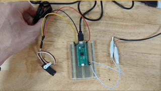

Step 2: Connect Switch Jack to Pico
Connect the switch jack to the Pico
  1. Wire 1 (either wire) to Pico Ground (Pin 3, 8, 12, 18, 23, 28, 33 or 38)
  2. Wire 2 (either wire) to Pico GP16 (Pin 21)
import time
pIn21=Pin(21, Pin.IN, Pin.PULL_UP)
if value >= 1:
else:
def sweep():
pwm0 = PWM(Pin(0))
pwm0.freq(50)
pwm0.duty_u16(1802)
time.sleep_ms(2000)
pwm0.duty_u16(5800)
time.sleep_ms(2000)
while True:
if not (pIn21.value()):
gpio_set(1, True)
sweep()
else:
gpio_set(1, False)
For testing purposes, you can use a button on the breadboard instead of a switch jack.

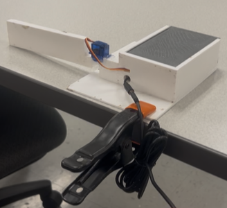

Step 3: 3D Print Enclosure and Arm
Print the sweeping arm and the enclosure.

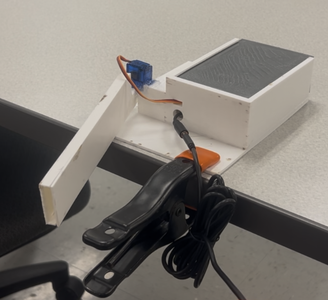

Step 4: Attach Servo to Sweeping Arm
Attach the plastic arm (which I hope you got with your servo motor) to the servo using the screw that (I hope) came with it.
We used hot glue to attach the sweeping arm to the servo motor's arm (just be careful that the hot glue doesn't get on the motor itself).
Step 5: Finish Assembling Enclosure
Use hot glue to attach the servo motor to the exterior of the enclosure. Run wires from the switch jack and the motor through the hole in the enclosure to the breadboard.
