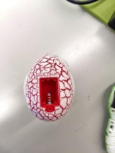

Locate the screw: There is only one screw to open the toy. It is located under battery compartment, partially covered by the spring.
Careful: There are wires that connect the two halves. Be careful not to try and tug the two halves apart, because these wire connections are VERY prone to breaking.

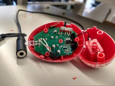

Location: The whole circuit board can be removed from the front side of the remote.
Careful: As you remove the circuit board, take care, as not to pull on the wires. They can and will break if you are not gentle. The buttons on the front half of the shell can come off as well, but can be easily put back on.
Note: There is no need to touch the switch on the side of the egg that is labeled A, B, C. Therefore, there is also no need to adapt it.
Tape: Tape down the black and red wires that connect the egg remote's shell to the circuit board. This will help to prevent these connections from breaking.

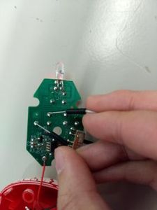

Location: On the circuit board, there are three locations that each have four silver dots in the shape of a square. Each one of these squares corresponds to one button on the egg remote.
Choice: Depending on whether you want all three buttons to be usable, you can choose to adapt one, two, or all three buttons. The second image, where the connection shown is at the top square, controls the go/stop button. This is the most important one, as it controls the snake's movement. The third image, which shows the square at the right, controls the right turn button. The fourth image, which shows the square at the left, controls the left turn button.
Mono jack: On the mono jack, there should be two wires. These are interchangeable. One of these wires will connect to one of the prongs on the square, as shown in the images above.
Make sure: Before soldering, make sure that the lead wire has been threaded through the exit hole in the correct direction.
Important: The connections on the two terminals CANNOT BE TOUCHING. Do not solder both free wires to the same terminal, and do not let solder connect the two terminals.
Soldering: Follow safety instructions for soldering.
After soldering: Wrap electrical tape around any exposed wiring. This will prevent the wires from crossing and touching after you reassemble the egg.
