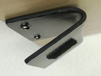

· Angle Brace -To mount the remote control at an angle for improved wireless communication with the shark
* We bent a piece of kydex plastic or you could cut a 4” piece of 2X4 at a 45 degree angle

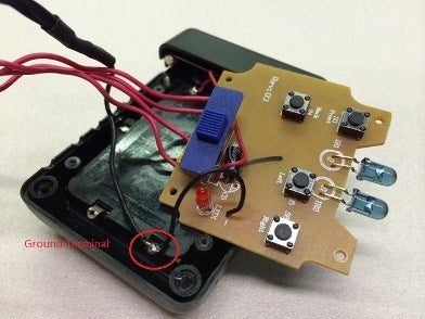

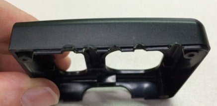

Take the controller for the flying shark and remove the screws to reveal the circuit board. Cut 5 notches in the case using a utility knife or file The wires will feed through these notches once re-assembled.
Step 3:
Solder one of the 7” red wires to the back side of each of the 4 switches. A total of (4) red wires will be soldered. See picture for reference. Label each wire up, down, left, right to save time later.
Step 4:
Solder the 3” black wire to the ground terminal.
Run the (4) red wires and (1) black wire through the notches created in Step 1 and close the controller back up.

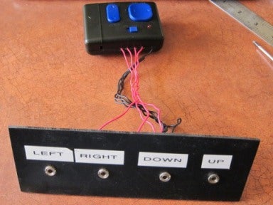

Slide the heat shrink tube over the black wire now outside of the controller. Solder the (4) 6” black wires to the one 3” black wire. After you have soldered them together, slide the heat shrink tubing over the union you just soldered and heat the tubing to shrink tight. If you don't have heat shrink tubing, you could also use electrical tape and cover the exposed wire.
Step 6:
  1. Pre drill (4) holes in Part E. In these pre drilled holes you are going to insert the (4) 1/8” mono panel mount audio jacks.
  2. Solder one red wire to one terminal on each jack.
  3. Solder the (4) remaining black (ground) wires to the other terminal of the mono jacks.
  4. Label each port with the labels on the wires you made earlier.

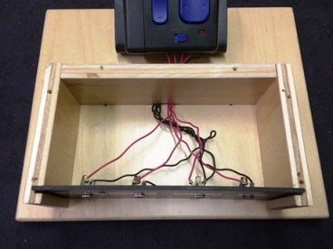

On 7 1/4” side of Top, cut a 1/4” deep 1/8” wide grove 1/4” in from the edge. Cut the same groves in Sides. Notch out a little spot on the bottom of Back for the wires to go through.
Step 8:
Assemble sides to back. Do not attach the top yet.
Step 9:
Insert the mono jack panel into the groves on the sides and back piece assembled in Step 9. Run the wires through the groove in the Back.
Attach the sides and back to the base as shown. Leave space for the controller.

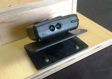

Build the angle bracket (for improved wireless communication with the shark) using plastic or wood and attach to the base. Velcro the controller to the angle bracket.
Step 11:
Attach the top with the remaining wood screws.
