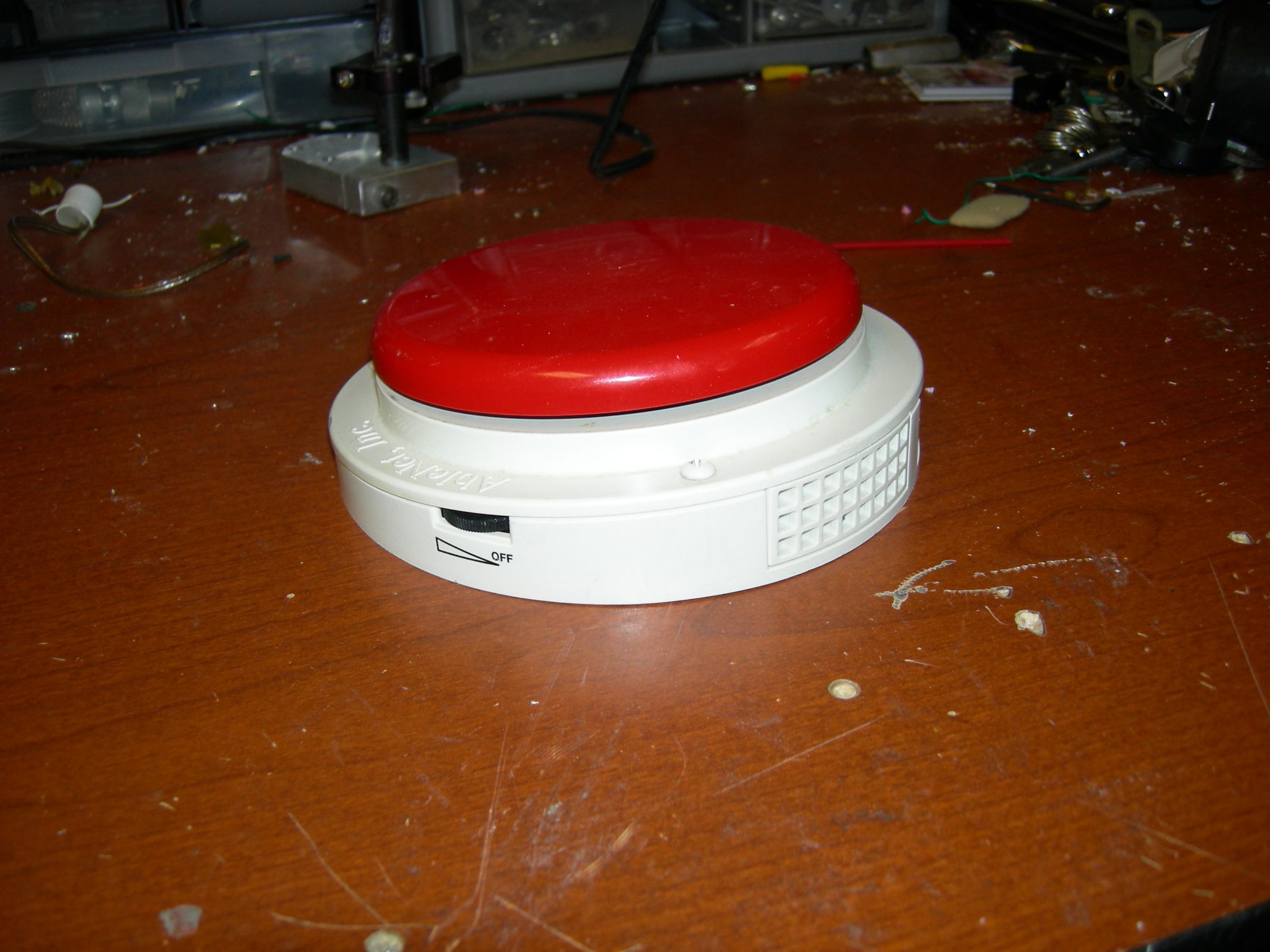

Step 5: Test
Plug in a spare ability switch and test to see that everything works.
If successful cover wires with electrical tape or shrinking wire wrap.
Stuff back inside sew back together of hot melt glue it and viola your done!!
