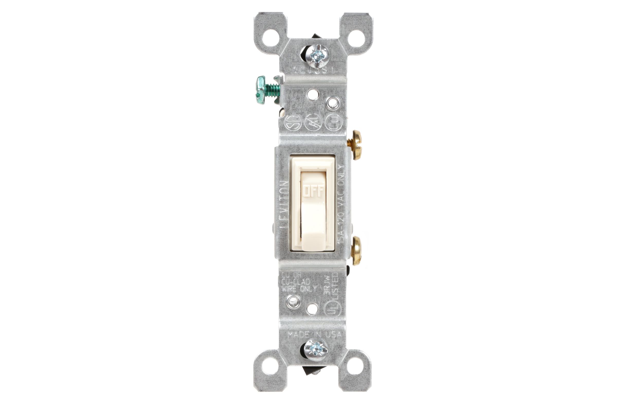

The standard light switch is basically little more than just a specialized toggle switch meant to handle a fair bit of electricity.

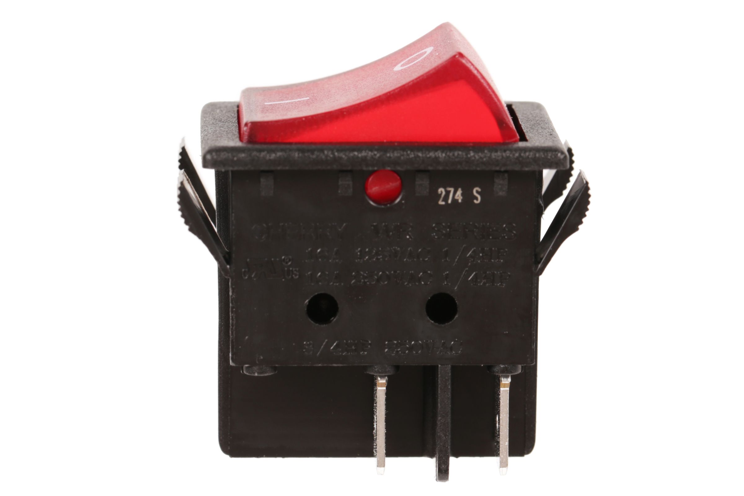

Very similarly to the toggle switch, the rocker switch moves back and forth. Instead of being pushed back and forth, it "rocks" or pivots along its center axis. They are commonly used as power switches and are sometimes illuminated (i.e. internally light up). These are typically mounting using rectangular holes, which makes installing them into an enclosure very annoying.

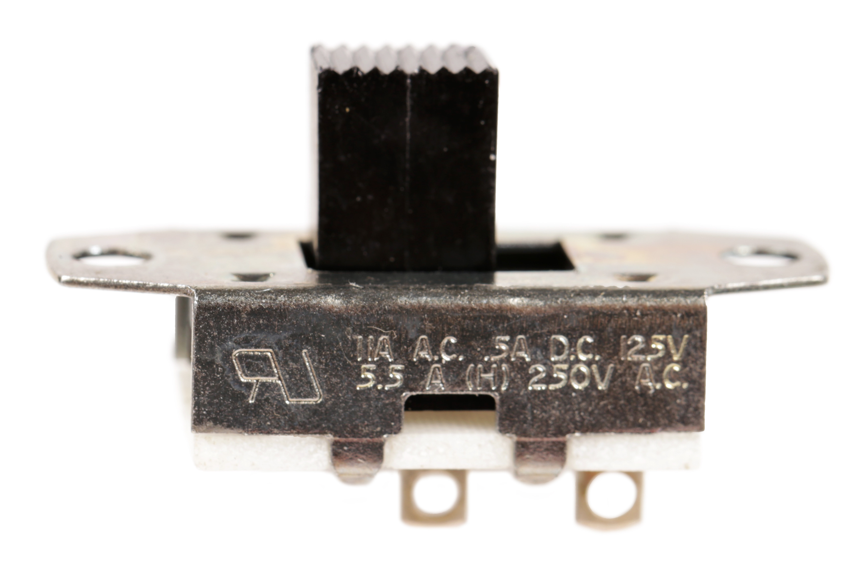

Just like toggle and rocker switches, the slider switch toggles back and forth. Unlike a toggle switch, the lever switch can have multiple positions to toggle between. However, most of the ones you might encounter are typically just two positions. These are commonly found as power switches in consumer devices.

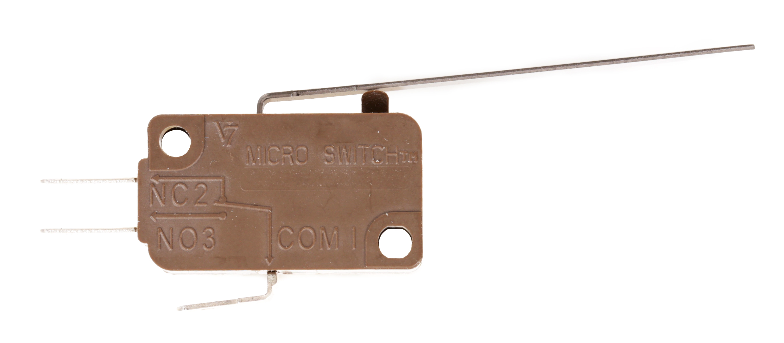

The lever switch is like a pushbutton switch, but has a lever which adds a mechanical advantage. The benefit to this is that it can be activated with very little force.

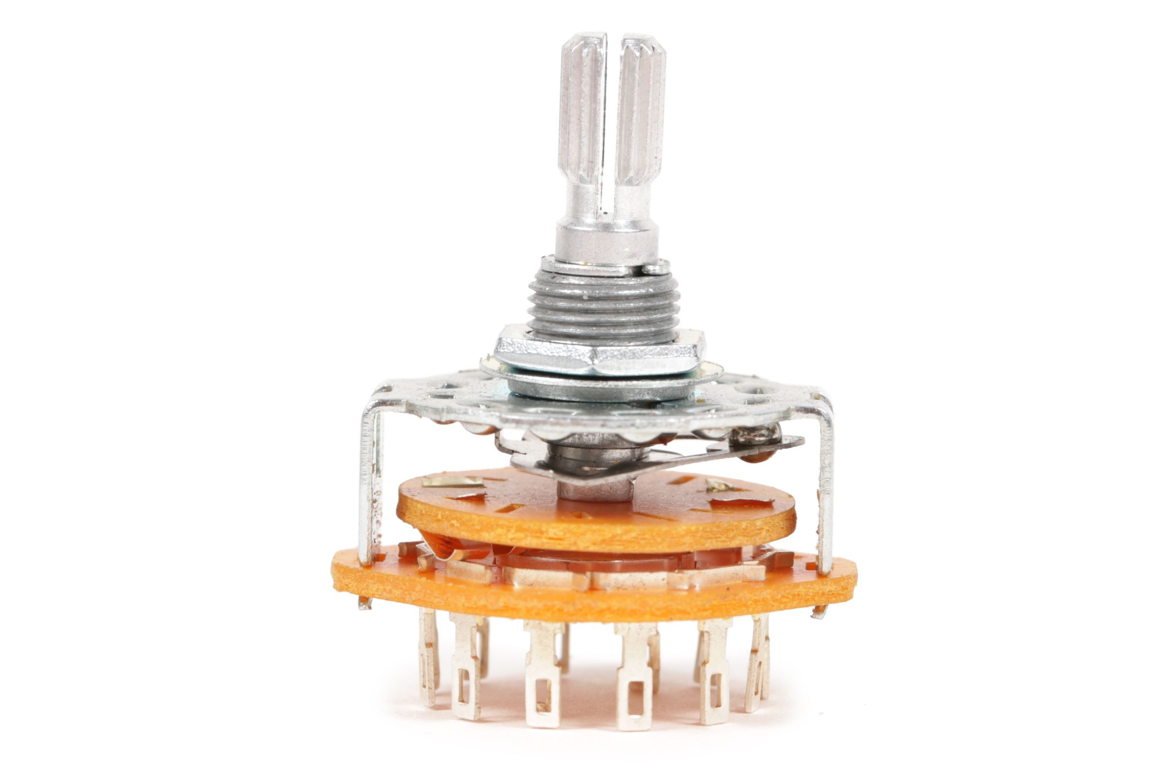

On the contrary, rotary switches typically require a fair bit of force to operate. However, what they lack in ease of activation, the more than make up for in number of inputs and outputs. By turning the knob you can toggle between a massive amount of different configurations of inputs and outputs. These switches are great when you need to toggle between lots and lots of different circuit combinations.

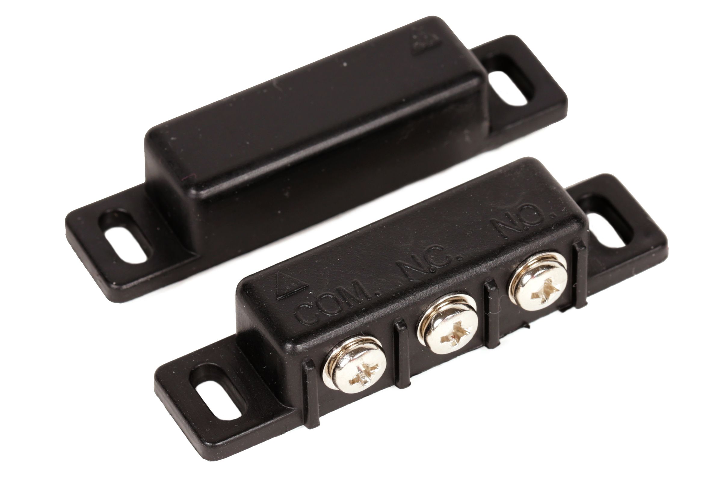

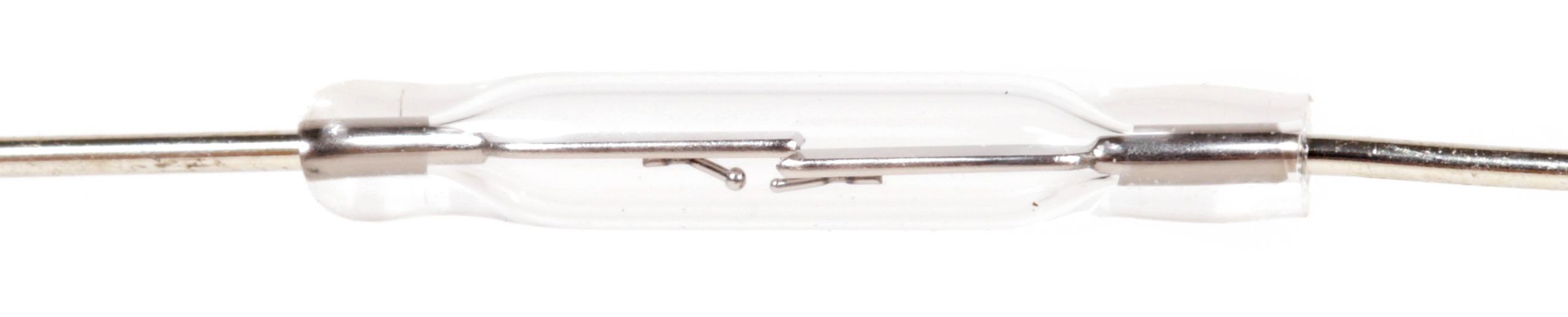

Speaking of switches and home access, the reed switch is commonly found as part of many home alarm systems. While it may seem complicated, it is actually just a switch that is activated by a magnet. In your home, the way it works is that when people open the window and slide the magnet away, the switch gets triggered. It's actually a really simple device consisting of two metal plates that are either pulled together or pushed apart depending on whether a magnet is present. In fact, if you listen very carefully, you can often hear the switch click when a magnet activates it.

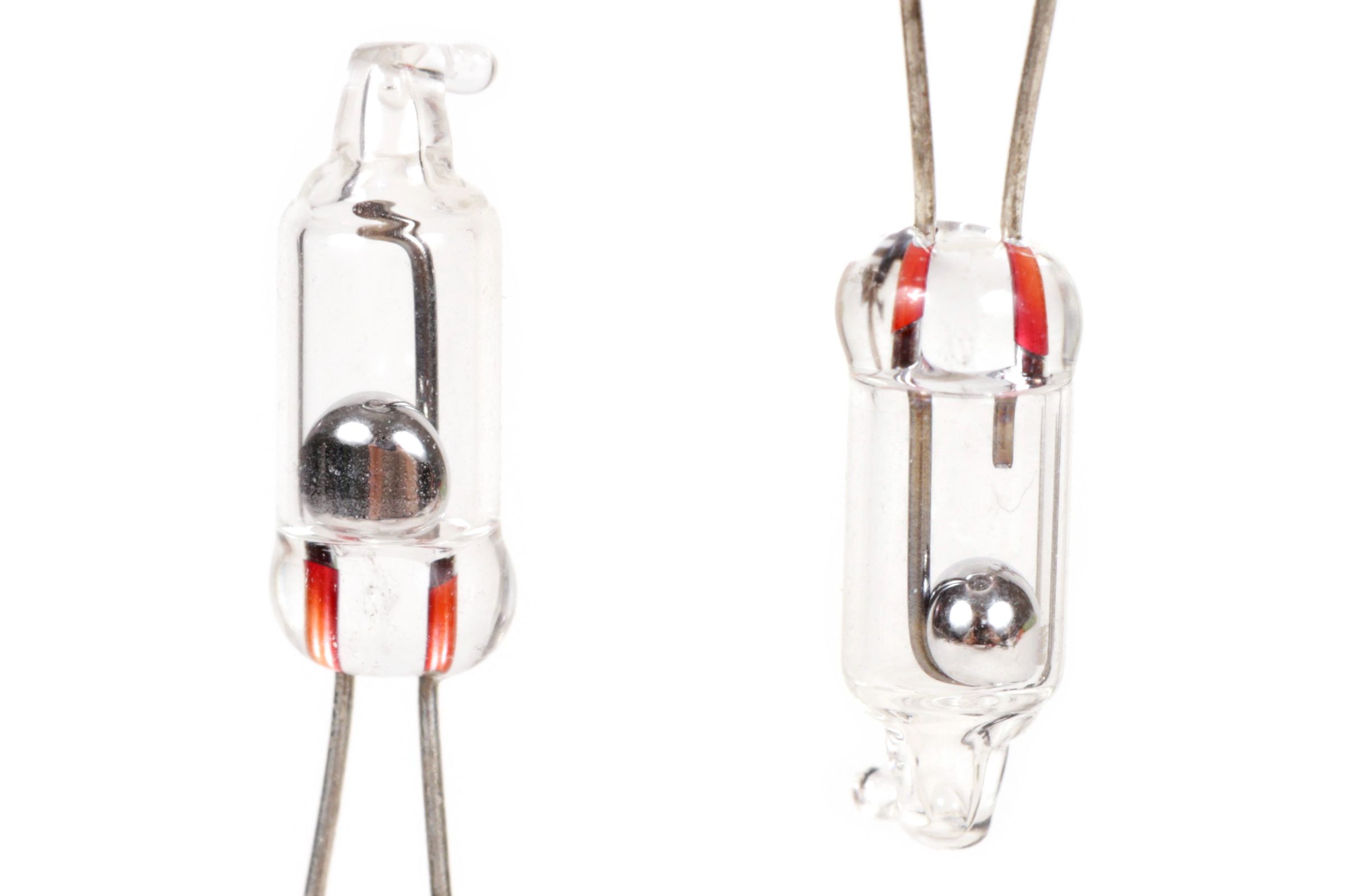

Moving on to other esoteric switches sometimes encased in glass, we have the tilt switch. What is cool about the tilt switch is that the connection is made depending on what direction it is tilted. Historically these switches used a mercury bead to make electrical contact between two wires (like the one pictured). However, in modern times, this has been replaced by a much safer metal ball. You can get switches which make or break connections at a number of different tilt angles.

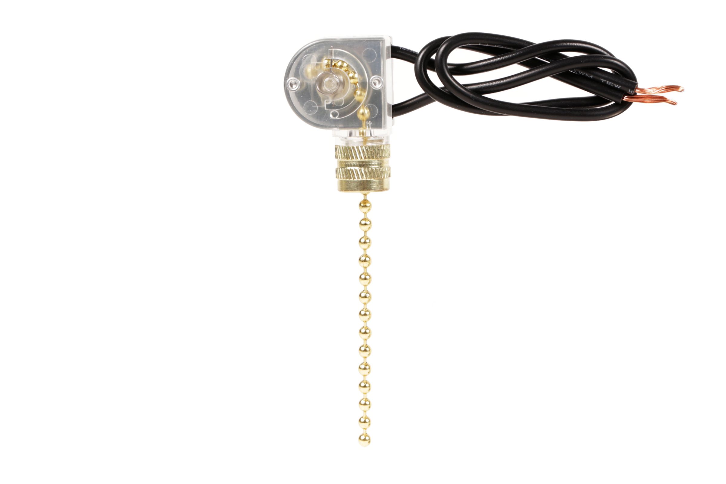

We're nearing the end, but before we get there I would be remiss not to mention the pull cord switch. This type of switch is activated when the cord is pulled and most often used in lamps and ceiling fans. While not used very often in other projects, it could be a fun switch to add to a project for a zany retro feel.

Step 5: Power!
The size of a switch is typically a good indication of how much voltage and current a switch can handle before it malfunctions. However, to be sure, just look at the switch itself. They typically have their power rating printed on them.
