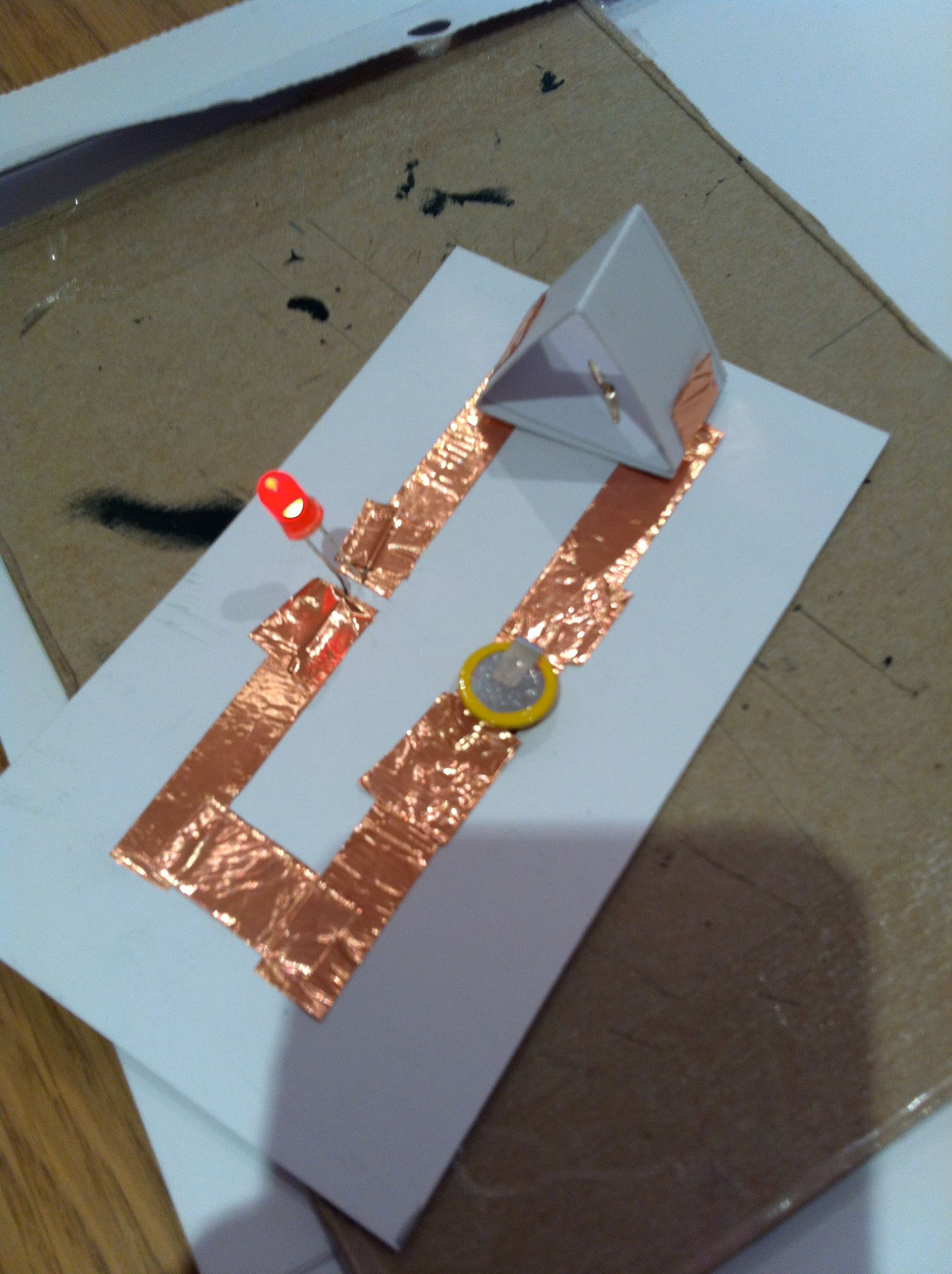

Apply copper tape to the LED and battery leads, securing them to the copper traces. Remember that the positive ends of the battery and LED should meet. The side of the battery with the plus sign should connect directly to the long lead of the LED.
Step 6: Add the Switches
Make a starter hole with your knife, scissors, or even a paper clip. Push the fastener through the hole and flatten the lengths so they make contact with the adjacent copper tape.
Step 7: Check Your Connections
Complete the circuit and see that your LED lights. Sometimes all you need to do is tighten the connections if the LED doesn't light at first.
