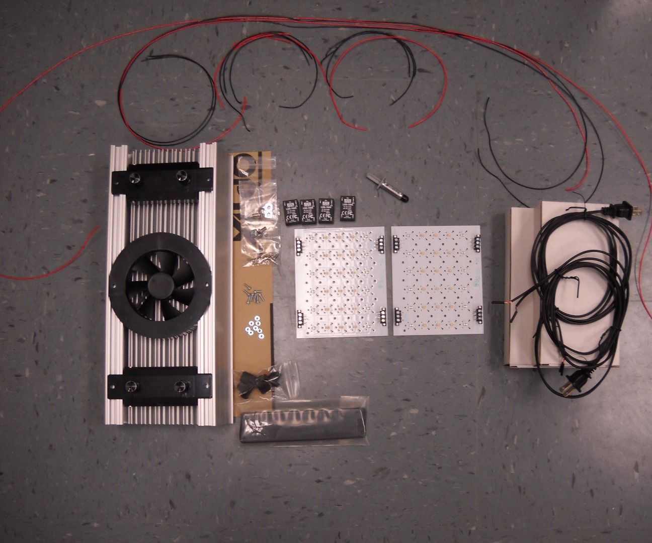

Step 1: The Light Engine
For certain light sculptures, my preferred light engine comes from LEDSupply's 1-up LED Dynamic light kit which includes an LED (your choice: Cree or Luxeon LEDs) and an optic to focus light, all enclosed in a billeted aluminum piece which can screw together. To power you will need a wired, dimmable BuckPuck (your choice: 350mA, 500mA or 700mA) and a proper wall wart (12VDC, 1 amp) to power the light engine.
Once an order is placed for a light engine kit, LEDSupply assembles the 1-up LED which is placed within the cylindrical aluminum housing along with your selected optic. The aluminum housing also acts as a heat sink for the LED. Extending out of the BuckPuck are 3 pairs of wires (six total). Two wires are attached to the potentiometer, two wires attach to the CREE XPG2, and the final two wires attach to a female terminal plug (plug size 5.5/2. 1mm) that is compatible with the wall wart power supply.
After the light engine is assembled and works, it should be tested within your application to answer the big questions:
- Where is your light engine going to be placed?
- How far will the light engine be from the wall wart connection point, and
- How far will it be from your control panel which will have your on/off switch and your dimmer?
If the light engine is further away from where you need the dimmer and the on/off (optional) switch control points, then take extra lengths of wire and carefully solder them to the BuckPuck dimmer and terminal wire outlets. This allows those wire connections to be extended and properly attached from light engine to the control point. In some cases starting the illumination of the light engine could be just plugging in your project. In this case there would be no need for an independent on/off switch.
