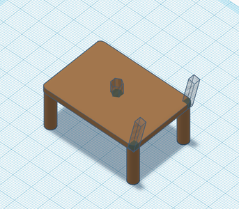

Step 1: The Table

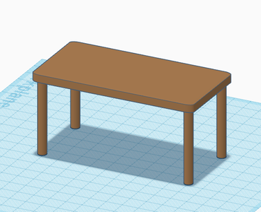

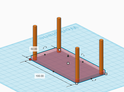

This is the simplest piece of the whole set so we'll start here:
  • In your new Tinkercad project bring in a square and resize it to suit your model - mine was 100 x 50 x 5. I also gave it a radius of 1 so there wouldn't be such sharp corners
  • Next, add a cylinder and again, resize it to suit your needs - mine was 5 x 5 x 50
  • Make 3 more copies of the cylinder
  • Use the align tool to place a cylinder in each corner of your table
  • Move each cylinder 2 mm towards the centre of the table so the table top overhangs the legs
  • Select all of your objects and group them together
That's your table done!

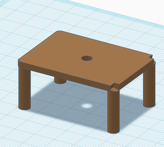

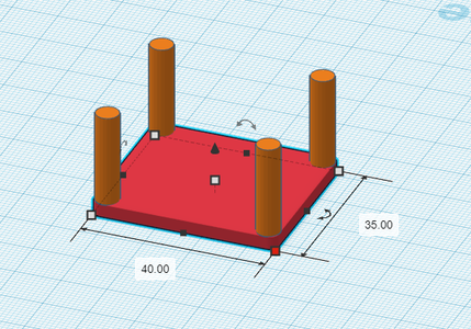

Let's start with the base of the chair - this is a very similar process to what we just did for the table, only a little smaller!

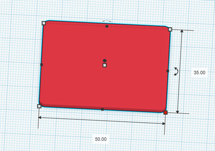

  • Same as with the table we'll need a square with a radius of 1 - this time mine was 40 x 35 x 3
  • Again we'll need 4 cylinders for the legs only a bit shorter this time - mine were 5 x 5 x 20
  • Next, we need to add some holes for the chair back and cushion to fit into - you may find it easier to work on if you flip what you've built over like in the 2nd picture
    • add 2 square holes of 3 x 3 x 15 and rotate them back so they are at a 10 degree angle
    • Place the 2 holes you just made in each corner at the back of the chair - check the 2nd picture for what this should look like.
    • Add a 5 x 5 polygon hole that passes all the way through the centre of the chair base
  • Group everything together
If you're wondering why we're using a polygonal hole and peg for this, it's because it won't allow the seat cushion to rotate once in place like a circular hole would - this hopefully means you won't need to glue it in place!

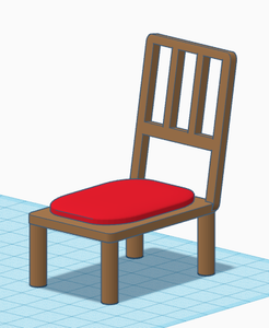

Step 4: The Chair Back
Last piece of the chair now - the chair back!
  • Again, we'll need to start with a square - mine was 35 x 50 x 3 and again had a radius of 1
  • Next place 4 square holes to create a slatted look - I used 25 x 8 holes for the 3 narrow holes and a larger 18 x 30 hole for the bottom
  • Group it all together!
That's it - you now have all 3 chair pieces ready to print!
Once printed, the pieces will fit together as shown in the last picture!

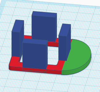

Step 5: The Highchair Top
The highchair is made of 2 parts - we'll start with the top.
Once printed the 2 pieces will fit together as shown in the first picture!

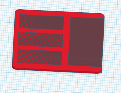

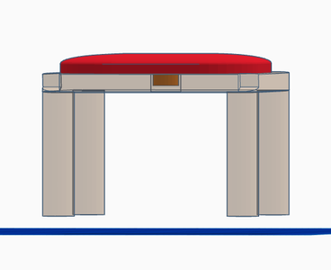

  • Bring in a square 25 x 30 x 3.5 with radius of 1
  • Duplicate the shape then make the duplicate 10mm smaller on each side

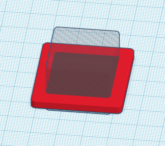

  • Make the duplicate a hole and align with the centre of the original square before grouping the 2 shapes - see picture 2 for guidance.

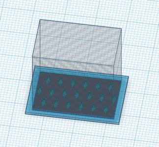

  • Add 4 more squares (shown in blue in picture 3) each should be 10 x 15 x 3 and align them with the centre of each side of your original shape as shown
  • Finally, add a round roof shape (shown in green in picture 2) 15 x 30 x 3 and place it along one edge of your model - this will be the tray

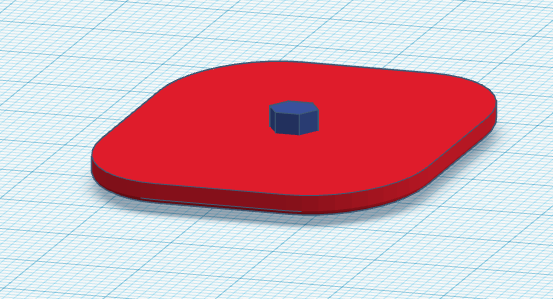

  • Select all of your shapes and group them - your model should now look like picture 4!

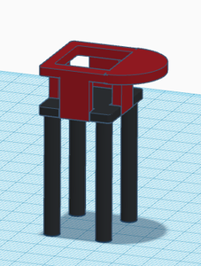

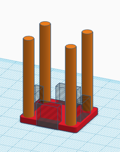

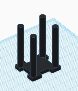

Step 6: The Highchair Base
Now we'll make the highchair base!
  • Bring in a square 25 x 20 x 3 with radius of 1 - this is shown in red
  • Add 4 square holes, each should be 11 x 4 x 15 and align them with the centre of each side of your original shape as shown in the first picture
  • Add 4 cylinders 5 x 5 x 35 and align one with each corner - these are shown in orange
  • Finally, group all of those pieces to make something that looks like the second picture
That's it! You've now got both of the pieces you need to make a highchair perfect for baby Sylvanians!

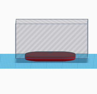

Step 7: The Cup, Plate, Jug and Bowls
Let's make some little accessories - I've given the placemat its own step as it's a bit more of a process but these pieces all use the same basic technique so I've lumped them together to save repeating myself!

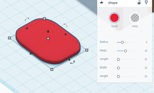

  • Take the basic shape closest to the object you want to make and resize it to suit your model e.g. for the cup I used an 8 x 8 x 10 cylinder and I've detailed below the shapes used for the other models.
  • Duplicate the shape and resize it so it's just a little smaller than the original - I made mine 6 x 6 x 8 in this example
  • Make the duplicate a hole and align it with the centre and top of the original shape
    Check out the first picture - I made the solid pieces transparent so you can see where the holes sit within all of the models
  • Group the shape with its corresponding hole - you should now have a hollowed out version of the original shape as shown in the second picture.
To make the bowl with straight edges I used the same technique starting with a 20 x 20 x 10 cone shape (top radius 10, bottom radius 8)
For the rounded bowl I used a half sphere, again 20 x 20 x 10, - you will need to use a square hole to cut the bottom off the half sphere to give it a flat base.
For the plate, I just used the same cone shape from the straight bowl and reduced the height to 2mm, then used a second cone shaped hole to give it a small indent.
The jug is just a 20 x 20 x 20 cylinder with part of a pyramid used for the spout - I flipped the pyramid overand used a square hole to cut it down to just the one point I needed then used the same technique as above to hollow it out.

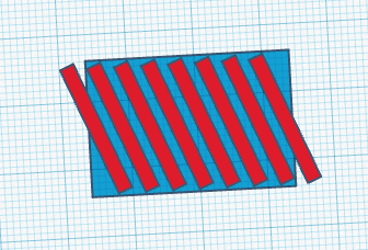

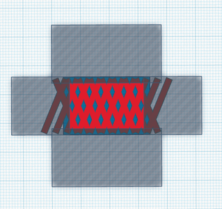

Step 8: The Placemats
The placemats are actually quite simple but involve a lot of little stages so I gave it its own step so I could include lots of screenshots as I think that might help to visualise what each stage is actually doing:

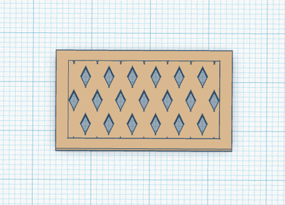

  • Place a square and resize it to the size you need, mine is 30 x 20 x .6 and shown in blue
  • Take a second square and resize to 2 x 20 x .4 then rotate it by 22.5 degrees (Tinkercad will snap to this rotation for you)
  • Duplicate the shape and then move it 4mm to the left - continue to duplicate until you have a row of pieces long enough to cover your blue square (See red shapes in 1st picture)
  • Group the red pieces together and duplicate them then use the mirror tool to flip the duplicate so you have a lattice pattern like the 2nd picture

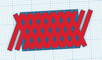

  • Add 4 square holes and place them so that they overlap the edges of the blue square by 2mm as shown in the third picture
  • Group the 4 holes and the red lattice (take care to not select the blue piece as well)
  • Create a final square hole the same size as the red lattice - check picture 4
  • Group it with the blue piece to create a border (take care not to select the lattice as well this time)
  • Group your lattice and border together!

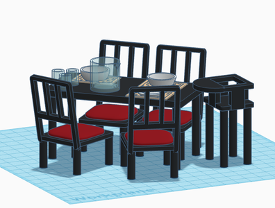

Step 9: Print!
You now have everything you need to print a table and chair set - and a few accessories too!
Export your STLs and slice!
This should be a pretty easy print - I won't tell you how to slice your files as it varies by machine, material, slicer etc. but here's a few tips based on the models themselves:
  • You shouldn't need any supports - I stuck to simple shapes with flat bases and separate parts purposefully so that it would be easy to print and you wouldn't have to waste material on supports
    The only place you may need very small supports is on the chair base - I had successful prints of all pieces without supports though.
  • Print smaller pieces more slowly - the chair back and accessories in particular have a fairly small footprint. If you're having trouble getting them to stay stuck you may need to clean and level your bed - if that doesn't fix it, slow the print down for the first couple of layers or add a brim or raft if you don't mind the clean up afterwards.
  • If you're making these for young kids to play with, I'd recommend printing in PETG as it's less brittle than PLA. I'd also suggest printing with at least 20% infill so the pieces are nice and strong too.
