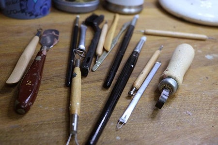

  2. sculpting tools: these can be purchased online or from any local craft or pottery store, the tools are not nearly as important as the techniques and talents to sculpt but a nice set of tools does make it easier.

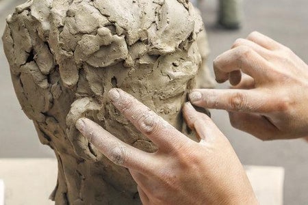

If you have never sculpted anything before this is probably not the project to start on, I would suggest to start small with oil based clays and or cheap clays and challenge yourself to make small detailed individual parts if sculpts (I.E. ears, eyes, a nose etc.)...
Once you feel confident to start its just a matter of doing it. here I started by building up a form with tin foil then padding the clay over top and adding a few layers. then its just about adding the details slowly and patiently. this entire sculpt took me approximately 19 hours broken up over a couple weeks. Please note that you may have to rip your creations apart and build them up again over and over again this is normal don't let it break you.
