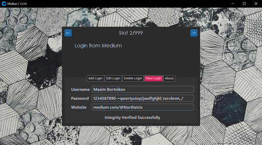

When you add a record to Midbar, it concatenates all the data you’ve entered into a single string, hashes it, and then stores that hash in the encrypted form.
When Midbar decrypts your data, it also decrypts the previously calculated hash and computes a new one for the decrypted data. It then compares both hashes and if they don’t match — Midbar notifies you that the integrity verification failed.

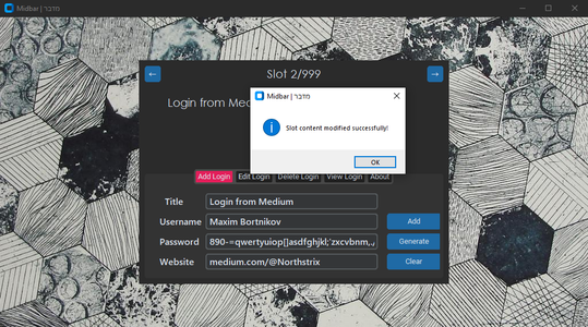

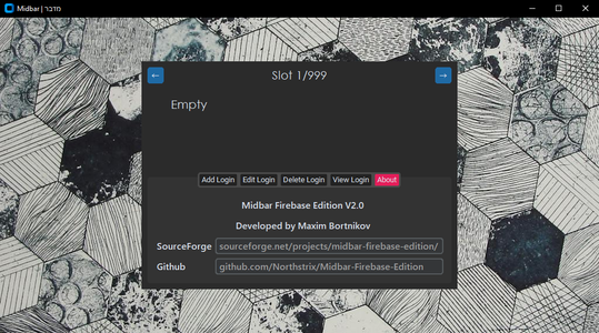

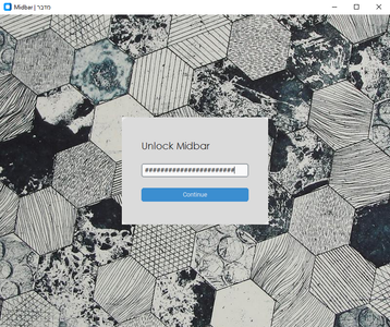

A desktop app capable of decrypting the data encrypted by the hardware MCU vault (and vice versa) is written in Python. GUI is made using the custom TKinter. Just like the hardware MCU vault, the desktop app connects to the Google Firebase and operates with the encrypted data stored there.

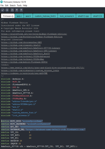

Step 11: Modify the Firmware
Open the “Firmware.ino” file from the “V2.0\Firmware” folder and put your values to the following variables:
WIFI_SSID
WIFI_PASSWORD
API_KEY
DATABASE_URL
After that, replace my keys with yours.

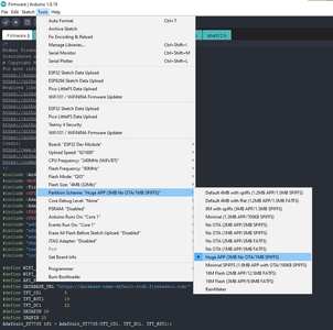

Step 12: Switch the Partition Scheme to the "Huge APP (3MB No OTA/1MB SPIFFS)"
You have to switch the partition scheme to the “Huge APP (3MB No OTA/1MB SPIFFS)” before you flash ESP32 because the firmware is too big for the default partition.

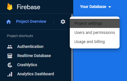

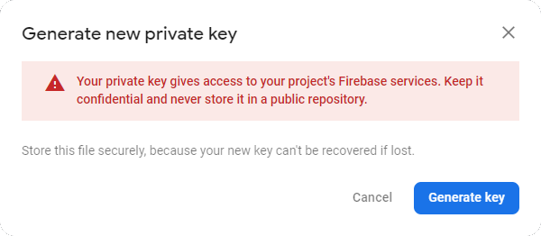

Step 15: Get the Firebase Private Key
To enable the desktop app to interact with the Firebase, you need to get the private key and place it in the same folder as the desktop (client) application.
To do so:
  • Open your database;
  • Click on the “Settings” icon;
  • Click on the “Project settings” line;
  • When the next tab loads, go to the “Service accounts” tab;
  • Click the “Generate new private key” button;
  • Click the “Generate key” button in the pop-up window;
  • Save the private key to the “…\V2.0\Desktop App” folder under the “firebase key.json” name.

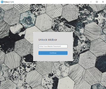

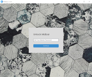

Step 18: Set Master Password
Once you configure the MCU password vault and the desktop app, set the master password. The master password can be set using the MCU password vault or the desktop app, whichever you launch first.
Step 19: Enjoy the Result
If you made it to that point, you should have a fully functional password vault that allows you to store your login credentials encrypted with the AES-256 CBC in the Google Firebase
