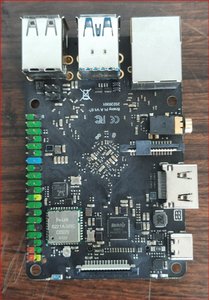

You only require a few supplies to set up your private backup server
1) Brainy PI/Raspberry PI} You can access it remotely also
2) Ethernet/wifi
3) SD card or hard drive
