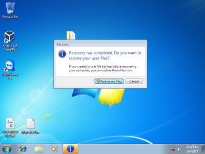

Step 7: Your System Is Restored!
You will now be prompted to restore your files, and your System Image is back on your PC!

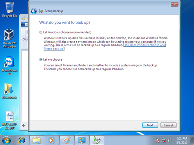

Step 10: What Do You Want to Backup?
It will then ask what you want to backup, either backing up what Windows chooses or what you the user chooses.
For this tutorial, check the ‘let me choose’ box, and then click ‘next’. This will prompt you to select what you want to backup. Check whichever directories are applicable to back up. Click continue.
