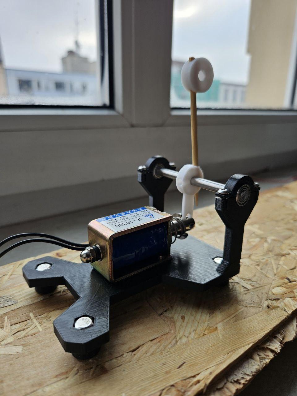

Hello Maker! This System for mechanical Sound installations was designed as part of my Bachelors Thesis with the goal of making a System that is modular, reproducable and affordable for other Students.
We are going to use an Arduino Uno R3 to control Solenoids. The trigger information is provided by a Max for Live Patch in Ableton that interprets Midi notes.
With this System you can integrate real live objects into your Ableton Live sets.
The System contains Solenoid actuators and a Hub which can control several Solenoids.

Step 1: 3D Print
Print in PLA: Basis, Fuß, Kugellagerhalterung, Schlägel
Print in ASA: Umlenkgabel
Step 2: Prepare the Prints
use the soldering iron to press metal inserts next to the grooves for the ball bearings.
Attach the feet with the base using M4 screws and nuts in the feet.
Attach the Solenoids loosely to the base with M4 screws and washers.
Step 3: Rotational Axis
Cut the 5mm metal rod to 11cm of length using a saw or similar and clean up the cutting surface.
Next, put the printed part "Umlenkgabel" on the rod. Using a cordless drill to rotate the metal rod while holding the print still really helps here.
The printed part needs to be in the middle of the rod to interface properly with the solenoid.
When you have the alignment right, fasten the screws holding the Solenoid.
Step 4: Mallet Time
Attach the Mallet ("Schlägel") to the rest of the build using a wooden skewer. You can easily adjust the height of the mallet by cutting the skewer shorter or longer.
