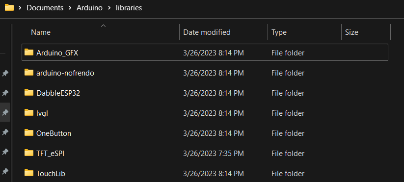

Step 4: Installing Libraries and Examples
Adding libraries to Arduino IDE
  1. Clone or download the folders located in the \lib directory to your local Arduino libraries folder (typically C:\Users\%USER%NAME\Documents\Arduino\libraries)
  2. Folders are located at the github repository: https://github.com/Xinyuan-LilyGO/T-Display-S3/tree/main/lib
  3. In the root folder (https://github.com/Xinyuan-LilyGO/T-Display-S3) you can use the green '<> Code' dropdown to download a .zip file containing the entire repository
  4. Your libraries folder should look like this:
  5. After a successful install the folders should show up in Files->Examples (all the way at the bottom)
