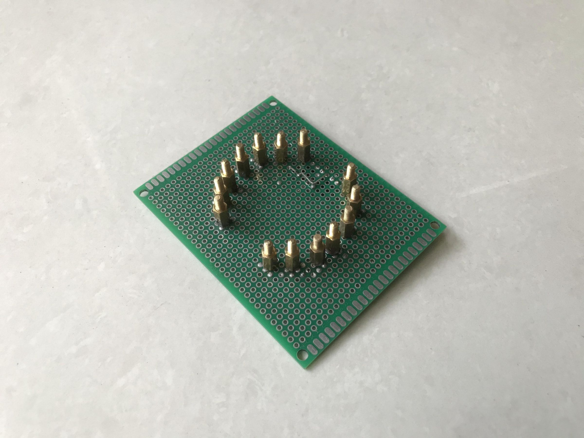

      Firstly, after measuring and marking, I drilled 14 holes on DIY PCB corresponding to the 14 alligator-clips of Adafruit Circuit Playground Express board. And I mounted copper pillars on the drilling holes.
      Then I plugged Adafruit Circuit Playground Express board on the copper pillars and did some adjustments to make sure their pads didn't touch each other.

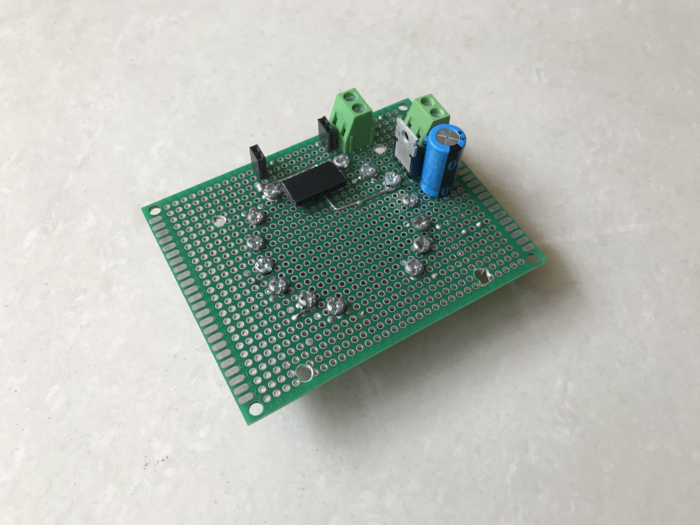

      At the PCB backside, I soldered a 6 pins female header to plug DS3231 RTC. You see the picture below, I used led pins, bent them into circles around the drilled holes and fixed them by soldering to PCB. This ensures good contact between the copper pillars and bolts.
      I continued to solder the remaining components according to the schematic diagram in the previous step.
      Plugging DS3231 RTC and AMS1117 on the PCB headers.
      Connecting speaker to PCB control board.
      Finally, I mounted speaker onto the PCB control board by some copper pillars. The PCB control board and speaker can be placed either horizontally or vertically.

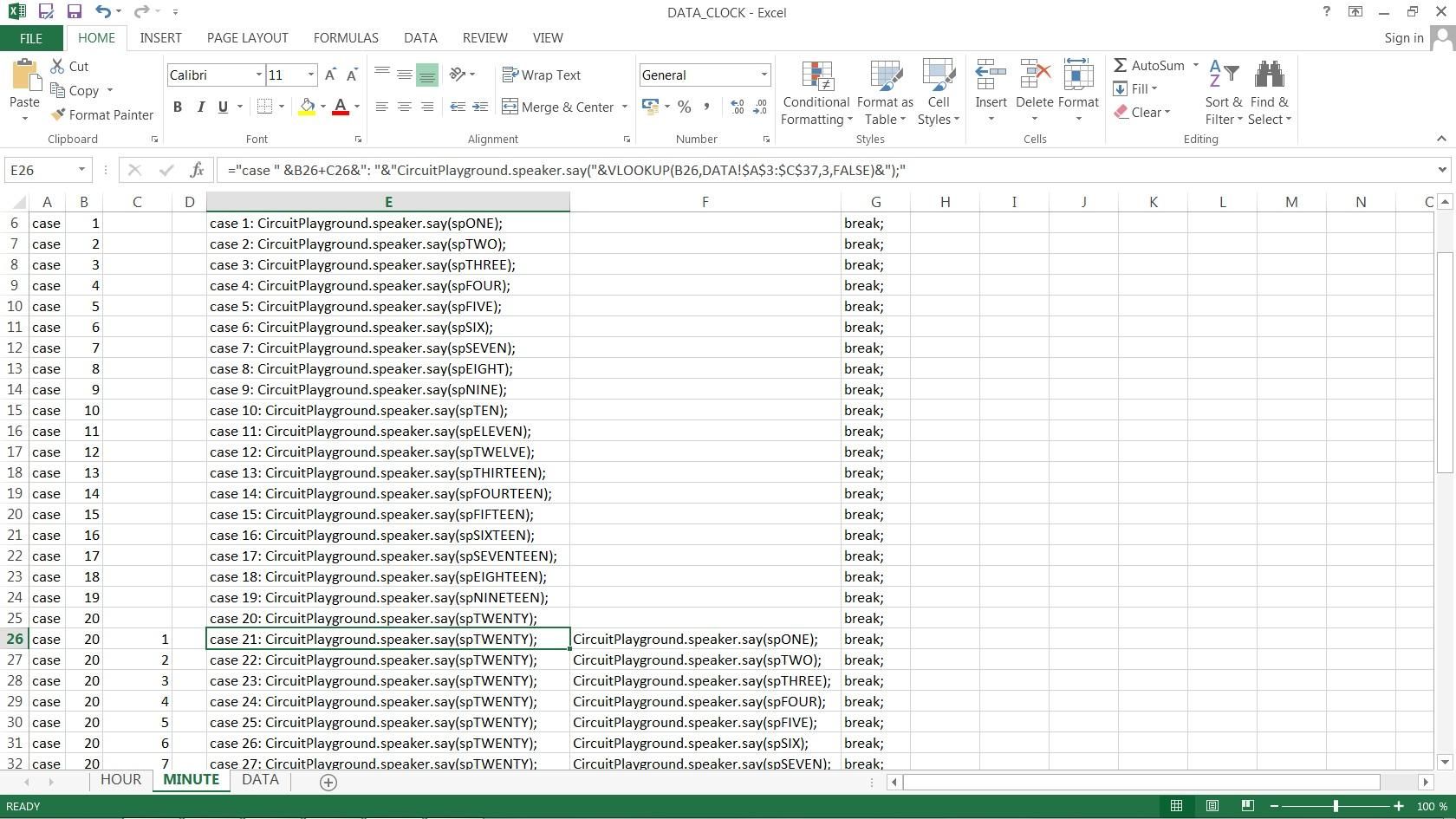

      • Microsoft Excel software helped me write Arduino program in this project, specifically for "switch...case" statements. Actually, we can use a concise programming way to convert time to voice but I like this style because Excel did it for me.
