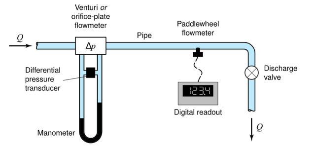

Laboratory setup is shown in the image above. The purpose of this manual is to calibrate bulk-flow measuring devices including the Venturi flowmeter, orifice-plate flowmeter, and the paddlewheel flowmeter. The Venturi and orifice-plate flowmeters are referred to as the "hydraulic" devices.

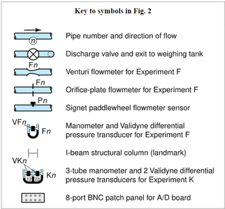

The key to the symbols of the laboratory setup above is given here.

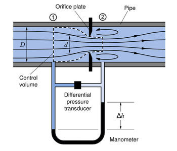

The internal mechanisms of the Venturi and orifice-plate flowmeters are shown here in this diagram. Notice how these devices run on a pressure transducer, meaning they rely on electronics to function.
