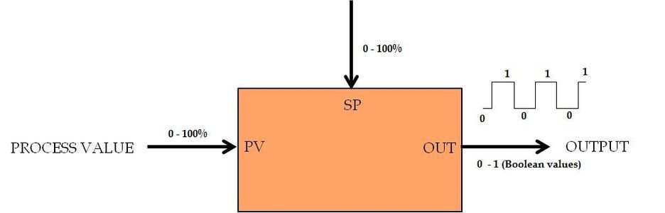

The diagram show in Fig. 2 is a typical ON_OFF control block.
Float position (PV) can vary from 0 to 100%.
With the SP (Set Point), we can fix the desire value of level.
If the level is lower than the SP value, then the pump is activated (OUT = 1) until the SP value is reached.
If the level is greater than the SP value, then the pump is stopped (OUT = 0) until the SP value is reached.
We can represent the operation of this control loop through the following equation:
PV – SP = Δ; Where Δ is the Error
if Δ > 0, then OUT = 0 (Boolean)
if Δ < 0, then OUT = 1 (Boolean)
Fig. 3 shows graphically the operation of the controller.
If the process value is less than the setpoint, output value will be “1” (activated pump)
If the process value is greater than the setpoint, output value will be “0” (pump off).

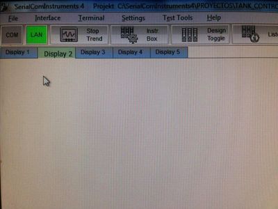

Step 3: HMI (Human Machine Interface)
At this time HMI (Human Machine Interface) is considered.
There is much software developed for HMI applications available in the market. LabVIEW, Wonderware, Panel Studio, FoxView, eLogger and Infilink are some of them
For the HMI of this project I found an application for micro-controllers in the web, called SerialComInstruments4 and develop by Ulrich Albert Maassen.
The web address to download this application is: www.SerialComInstruments.com
In the figure 4, I show the screen for the project. There, you can see the tanks, valves and the pump, in the left side are the numeric values expressed in % (0%-100%). At the top-right of the screen you can see the trending of the variables of the tank. Status of the pump can be observed in the indicator above the pump.
SerialComInstruments4 allows you to create environments to build process displays where you can see the process values, set points, Trends, X-Y Graphics, Numeric Displays, Vertical Meters and Digital Displays.
In the main menu you will find six fields to access the different functions of this application:
File, Interface, Terminal, Settings, Test Tools and Help
You also can perform the following functions:
COM: If you select “COM”, you will be able to Connect and Disconnect the interface
LAN: Network connection
Start /Stop Trend: Start or Stop the trending of process variables
Design Toggle: In this field you can go to the Edit Mode. In this mode you can build your display
Liste: Displays a list of all the instruments that you used in your design
Display1, 2, 3, 4, 5: Allows you to select the desired display (display 1, display 2, etc.)
If you select “File” you can start a new Project, Load and Save a Project (Figure 4.1)

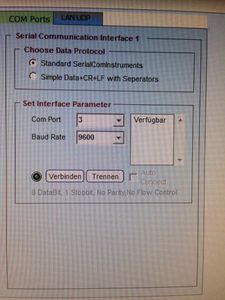

You can select the Serial “Interface”, where you specify: Com Port, Baud Rate, also you can change the Data Protocol (Figure 4.2.1 and figure 4.2.2)

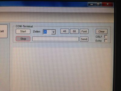

"Terminal" menu allows you to visualize serial data in the screen (Figure 4.3)

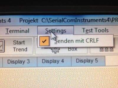

In "Settings" you can activate the Carriage Return and the Line Feed (Figure 4.4)

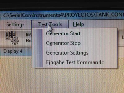

In "Test Tools" menu you can simulate process changes through a sinewave generator and a ramp wave generator (Fig. 4.5)

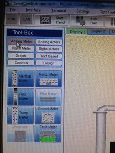

Selecting the field “Instr. Box” you can select a diversity of resources for your project Vertical, Flex and Horizontal Meters are available in Analog Meter of the Tool Box (Figure 4.6)
Numeric Display and Led’s are available in Digital Meter of the Tool Box
Trends are available in Graph of the Tool Box
Analog Sliders are available in Analog Actors of the Tool Box
Switch Buttons and Button Panels are available in Digital Actors of the Tool Box
Text Displays are available in Text Based of the Tool Box
Background and Text Labels are available in Design of the Tool Box

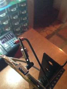

- Figure 10 shows the detail of the level potentiometer

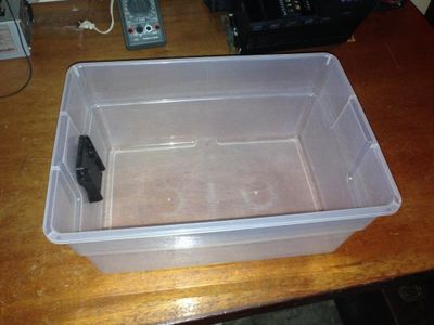

- Figure 11 shows the plastic container (TANK_2)

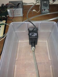

- Figure 12 shows the Submersible Pump installed in the plastic container
