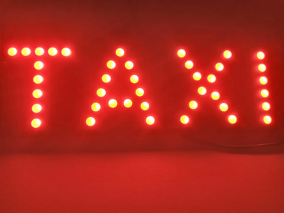

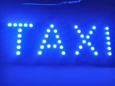

Today we will see a control of rgb led lights for a car with the word taxi the color sequence is programmable

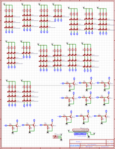

Step 1: SCHEMATIC DIAGRAM
Here we will see the schematic diagram made in the easyeda software with all the electronic components and their respective values.
Step 2: FUNCTIONING
Mainly we will have an external supply of 12VDC for our pcb since we need to feed our arrangement of leds in this case they are in series of 3 each led respectively each color red blue and green.
This circuit can control the lighting of the different pins of the RGB LEDs, giving me different colors that I may want as long as the complete word or control each letter of a different color.
The project needs to be programmed as we may require the color, already through an Arduino and another microcontroller. In this case, we will do it through an Arduino and see the different colors as a programming example.

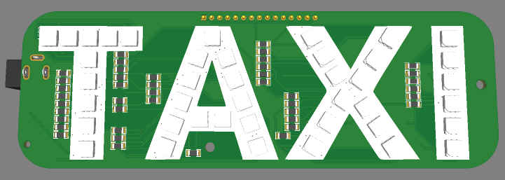

Step 5: PCB TECHNICAL CHARACTERISTICS
- EXTERNAL VIN 12VDC
- PROGRAMMING WITH ARDUINO OR ANOTHER MICROCONTROLLER
- CONTROL OF RGB BLUE RED AND GREEN LEDS
- IMAX 500mA
- ULTRA BRIGHT LEDS
