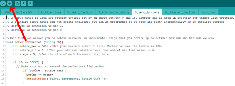

Step 4: Export Code to Arduino
Specifically, export the servo functions provided and send the file to the robot in which you would like to install the turret controls.
Reminder: Make sure to disconnect Bluetooth module from robot prior to connecting Arduino to computer.
The file itself simply defines how fast the continuous servo should rotate when input is given. This allows the turret to rotate in full 360° motion.
