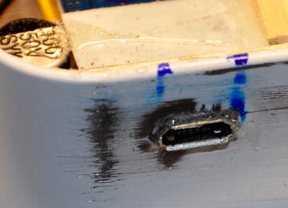

1. Make holes in the Altoids Box.
- 9 x LED coming from the PCB

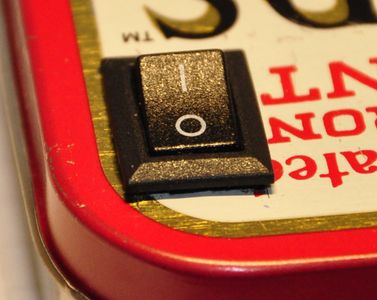

- switch
- USB Charger

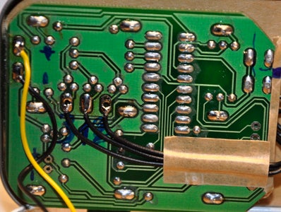

2. Cut the PCB, make sure the PCB fit in the lid.

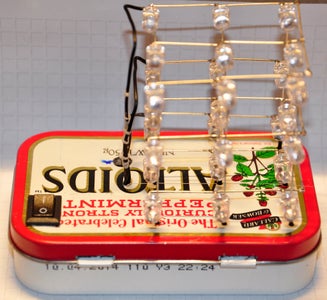

3. Solder the CUBE, use any technique you like, when you attach the Cube to the LID isolated the leads with some shrink tube.
4. Solder the LED's to the PCB

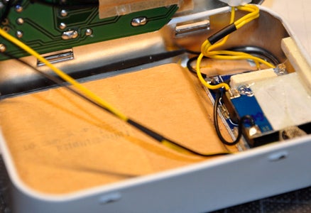

5. find place for the other components, if it not fit shrink it or search a bigger box. If both are not possible, then I'm sorry you can't make a LED Cube in an Altoids Box.
