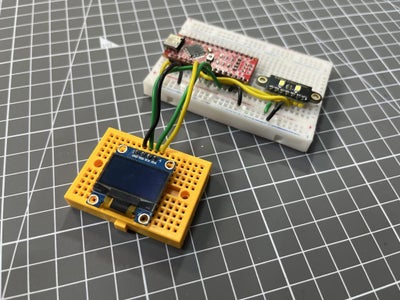

Step 3: Circuit Diagram:
I made the circuit using the diagram given above, you can also see the graphical representation of the components below. I got this TCS3472 colour sensor from PCBWAY gift store through the beans collected from previous order.
Here both sensor and OLED work on same I2C bus but with different address. This bus can go up to 127 devices and here we are using only two. SDA and SCL pin is connected to A4 and A5 of the Arduino respectively. This sensor module has onboard 3v voltage regulator that’s why VCC is supplied with 5V and GND is common to all.

Step 6: Lux Measuring:
We can measure all the values in real time and this lux meter is integrated with colour sensor, you can see the readings from OLED.
