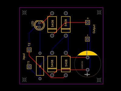

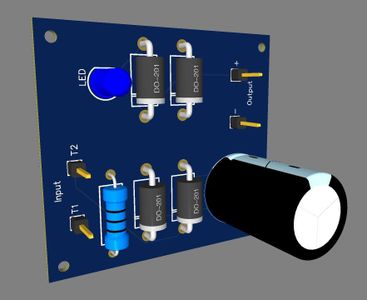

Step 9: 12v Power Supply Design
The schematic of 12v power supply circuit design along with the PCB layout can be seen above. Here Led light used to measure the voltage or used to check the accurate voltage of this circuit. To check this circuit, you also can use DC meter.
Step 10: Bridge Connection of Power Supply
To make this circuit, 1st we need to make a bridge connection. We know that, there are two polarity terminal of a diode. To make this bridge connection, we connect two diode negative terminal and connect due two diode positive terminal with the circuit. Then we connect , two set diode positive leg with another diode negative leg and connect other terminal with the circuit. It’s a complete bridge connection.
Step 11: Filter Output Voltage
To filter voltage, we need to use a capacitor with the circuit. We are using 2200µf/ 25v capacitor with this circuit. We connect capacitor negative leg with diode negative leg and connect capacitor positive leg with diode positive leg.
Step 12: Connect Indicator System With Circuit
For indicator, now we connect resistor and LED with the circuit. We are using 1k resistor to make this circuit. We connect resistor with capacitor positive leg and connect LED positive leg with resistor. Then connect LED negative leg with positive & negative leg of diode.
Step 13: Connect Transformer With Power Supply
For power source we are using 12v transformer. If we want to make 15v power supply, for that we need to connect 15v transformer. Now we connect transformer secondary section with the circuit. We connect secondary section cable with diode positive and negative leg.
We’ll get output voltage from capacitor positive and negative leg. Positive voltage from capacitor positive leg and negative voltage from capacitor negative leg.
