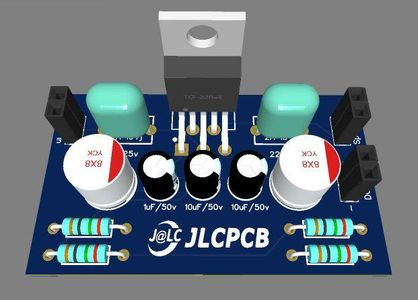

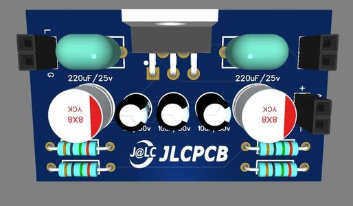

Step 5: Hardware of SMT Project Circuit
To make this mini power amplifier circuit, we might need some electronics component. JLCPCB has its own parts library. JLCPCB has 200k+ in stock components, 24 hours rapid SMT assembly. You can check SMT parts library here - https://jlcpcb.com/parts

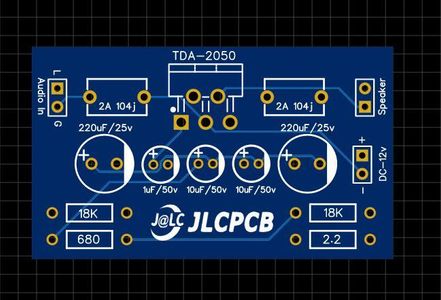

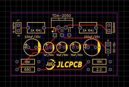

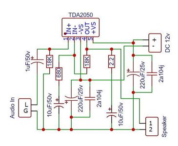

Step 6: Schematics and PCB Design
The schematics of PCBs can be seen above.
Step 7: Circuit Connection – Step 1
To make this high quality amplifier circuit, 1st we connect 18kΩ resistor with 1no leg of sound IC. Then we make a parallel connection between two resistors. That resistor is 680Ω and 18kΩ. Now connect, it’s parallel point with 2no leg of sound IC and other terminal of 18kΩ resistor with 4no leg of TDA-2050.
The other terminal of 680 ohm resistor is open now. Connect 10µf/50v capacitor with empty terminal of 680 ohm resistor.
Then connect 1µf/50v capacitor positive leg with 1no leg of TDA-2050 sound IC.
We utilize JLCPCB https://jlcpcb.com/RTA  to printout our PCB.
Step 8: Circuit Connection – Step 2
To make it in a easy way, now we connect a 220µf/25v capacitor and a polyester film capacitor with each other. Now connect this capacitor negative leg with 3no leg of sound IC and the capacitor positive leg will be empty now.
As above, we make a connection between polarity film capacitor and a polyester film capacitor, at the same way we make same connection between these two components.
This time, we connect this capacitor positive leg with 5no leg of sound IC. But at the moment, it’s negative leg will be empty, until we connect it with other components
Step 9: Circuit Connection – Step 3
It is the time to connect 2.2Ω resistor with our powerful amplifier circuit. We connect this resistor with 4no leg of sound IC and then connect 10µf/50v capacitor positive leg with the empty leg of 2.2Ω resistor.
Our circuit connection going to the last position. Now, we jest connect sound speaker, audio input cable and power source with the circuit.
Step 10: Circuit Connection – Step 4
To input audio, now we need to connect audio input cable, with the circuit. Connect audio input L/R cable with negative leg of 1µf/50v capacitor and connect audio input “G” cable with 18kΩ resistor, that is connected with 1no leg of IC .
For output audio, now we connect a sound speaker with the circuit. Connect sound speaker one terminal with 4 leg of IC and other terminal with 18kΩ resistor, that is connected with 1no leg of sound IC.
To operate this amplifier circuit, now we just connect power source with the amplifier circuit. For power source, we are using DC-12v. We connect DC-12v positive cable with 5no leg of IC and DC-12v negative cable with 3no leg of IC.
Step 11: Circuit Connection – Step 5
Our circuit is now completely ready for use. Now, we need to connect a heat sink with the sound IC. Then just plug in power, connect audio device with audio input cable and play music.

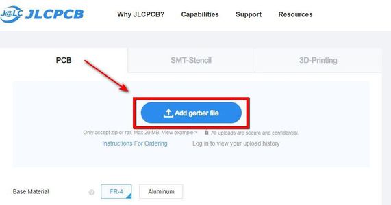

To order PCBs, make your Gerber file. Then drag and drop the Gerber file on the following box.
Click on “Gerber Viewer” button you can check the PCBs design. Make sure everything is good, then choose color, quantity and order your PCBs at very reasonable prices.
