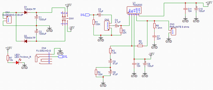

We continue with the sequence of amplifiers but this time we will use a 30W amplifier, that is, we will use 2 TDA2030 amplifiers for each channel, both for L and R.
Step 1: SCHEMATIC DIAGRAM
HOW WE CAN SEE THIS SCHEMATIC DIAGRAM IS ONLY FOR ONE CHANNEL BUT WE WILL ONLY HAVE TO COPY THE SAME AND DO IT FOR 2 CHANNELS AND HAVE A STEREO OUTPUT A VERY CHEAP AMPLIFIER AND ABOVE ALL IDEAL FOR OFFICES OR ROOMS OR MP3 CELLULARS ETC

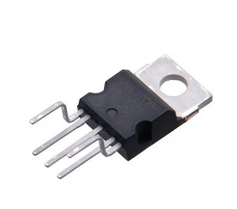

The TDA2030 is a monolithic integrated circuit, intended to be used as a low frequency AB amplifier. Typically provides 14 W of output power at 14V / 4Ω; at ±14V or 28V, the guaranteed output power is 12W into a 4Ω load and 8W into an 8Ω load. The TDA2030 provides high output current and has very low harmonic distortion. In addition, the device incorporates an original (and patented) short-circuit protection system comprising a provision to automatically limit power dissipation in order to keep the duty point of the output transistors within their safe operating area. A conventional thermal shutdown system is also included.

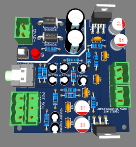

Once the professional pcbs are obtained, we begin with the assembly of all the electronic components and begin to assemble them.
Step 4: Welding
and now we will start to solder all the electronic components with a soldering iron and tin at up to 250 °C

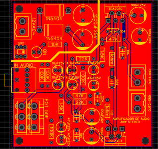

Step 6: EASYEDA
Here we finished the project with the design of the pcb in EASYEDA and it will give us as a result the 3D image and the finished tracks and after a few days our PCB will reach the door of our homes with a very professional finish
