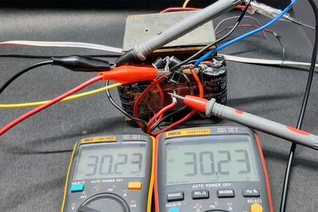

Considering the 30-0-30 transformer shown above will output more or less 30-0-30V AC if the input supply voltage is 230V. But as AC mains input always drifts, the output will also drift. Considering that fact, we can now calculate the amplifier's supply voltage. The transformer gives us AC voltage and if we convert that into DC voltage, we will get
VsupplyDC = 30*(1.41) = 42.3VDC
This value is a little bit more than what we were targeting initially but it is within the absolute maximum rating of the device according to the datasheet. It can be clearly stated that the transformer can deliver 42.3VDC when the input is 230V AC. Now if we consider voltage drift of 5%, we can see that the maximum output voltage becomes
VmaxDC = (42.3 +2.4) = 44.77V
Which is well within the maximum supply voltage range of the TDA7294 IC

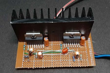

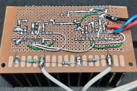

For the demonstration, the circuit is constructed on a handmade dotted perf board with the help of a schematic. Please note that if we are connecting a big load to the output of the amplifier, a huge amount of current will flow through, and to overcome that we have used a single strand of CAT6 cable to connect the power line in the perf board.
In order to make the circuit a little bit smaller and reduce complexity, I soldered some of the resistors to the backside of the perf board as shown in the below image.

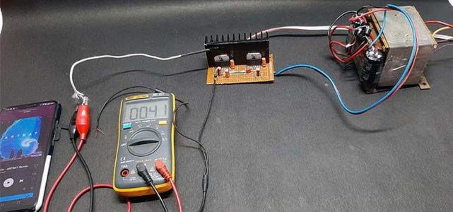

Testing of TDA7294 Amplifier Circuit
The testing process will be very simple, we will connect the power supply and a load to the amplifier. Also, we will connect a temperature sensor to the amplifier to monitor the temperature and we will let it run.
To test the circuit, the following apparatus was used.
  1. A transformer which has a 30-0-30 Tap
  2. A 16Ω 180W speaker system as a load
  3. Meco 108B+TRMS Multimeter as the temperature sensor
  4. And my Samsung phone as an audio source

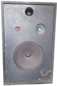

The Speaker System used is shown below. As mentioned earlier this is a 180 Watt speaker system with a 150 Watt RMS main speaker, a 15Watt tweeter for treble, and another 10 Watt of the speaker to output the vocal.
Also, you can see the room temperature was 22°C during the time of testing. At this moment, the amplifier was in an off state and the Multimeter was just showing the room temperature. Generally, the audio output of this amplifier is very good and can be improved by adding an Audio Tone Control Circuit alongside it.
You can see from the above image; the results were more or less great and the temperature of the IC didn't go beyond 41 °C during the testing. After using it for an hour the temperature did not move over 55°C.
