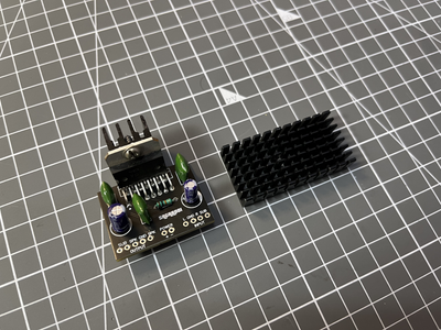

Either we can use this IC in bridge mode or in simple mode. Because it has 4 channel max output which can give 6w per channel on a 4ohm load. And I am using the stereo + bridge configuration. Which makes a 2.1 channel amplifier (1 channel for subwoofer and two for speakers). The standby is kept on high for the amplifying action of the TDA7377. And we can build this 2.1 amplifier using minimal components.

Because of 35watt mini package the IC already has a good copper heat dissipating sink, but it is recommended to add a 20x20mm heatsink with this IC. So that no thermal damage will be there. Soldering can be done very easily first by placing small resistor then capacitors and then TDA7377.
