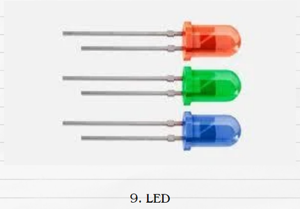

  9. LED
  10. Resistor

  4. Connect LED to breadboard using (ESP32).
  5. Connect cathode from LED with male to female jumper wire and connect to GND (ESP32).
  6. Connect anode from LED to resistor then connect male to male jumper wire with female to female jumper wire that connect to D13 (ESP32).

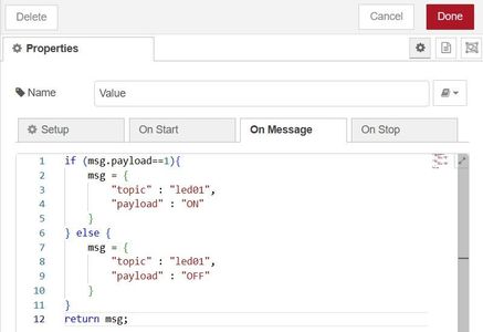

For LED
1. Add Switch node
2. Add Function node
   * this is the code for LED
3. Add MQTT Out node
4. After that, connect the switch node to the function node.
5. Then, connect the function node to the MQTT Out.
6. After that, click button Deploy at the right above.
